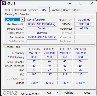

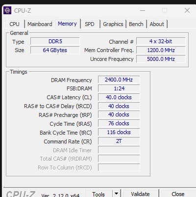

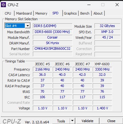

I purchased some Corsair VENGEANCE DDR5 RAM 64GB (2x32GB) 6600MHz, CL32 (CMK64GX5M2B6600C32) kit last week. But I cant get this ram stable past the default. If I enable Intel XMP, the system will not boot. If I increase the speed a bit, it will boot but I get the BSOD or when I start a game, it will hard crash.
Specs from CPUZ
From my BIOS, everything is still at default, nothing is overclocked.

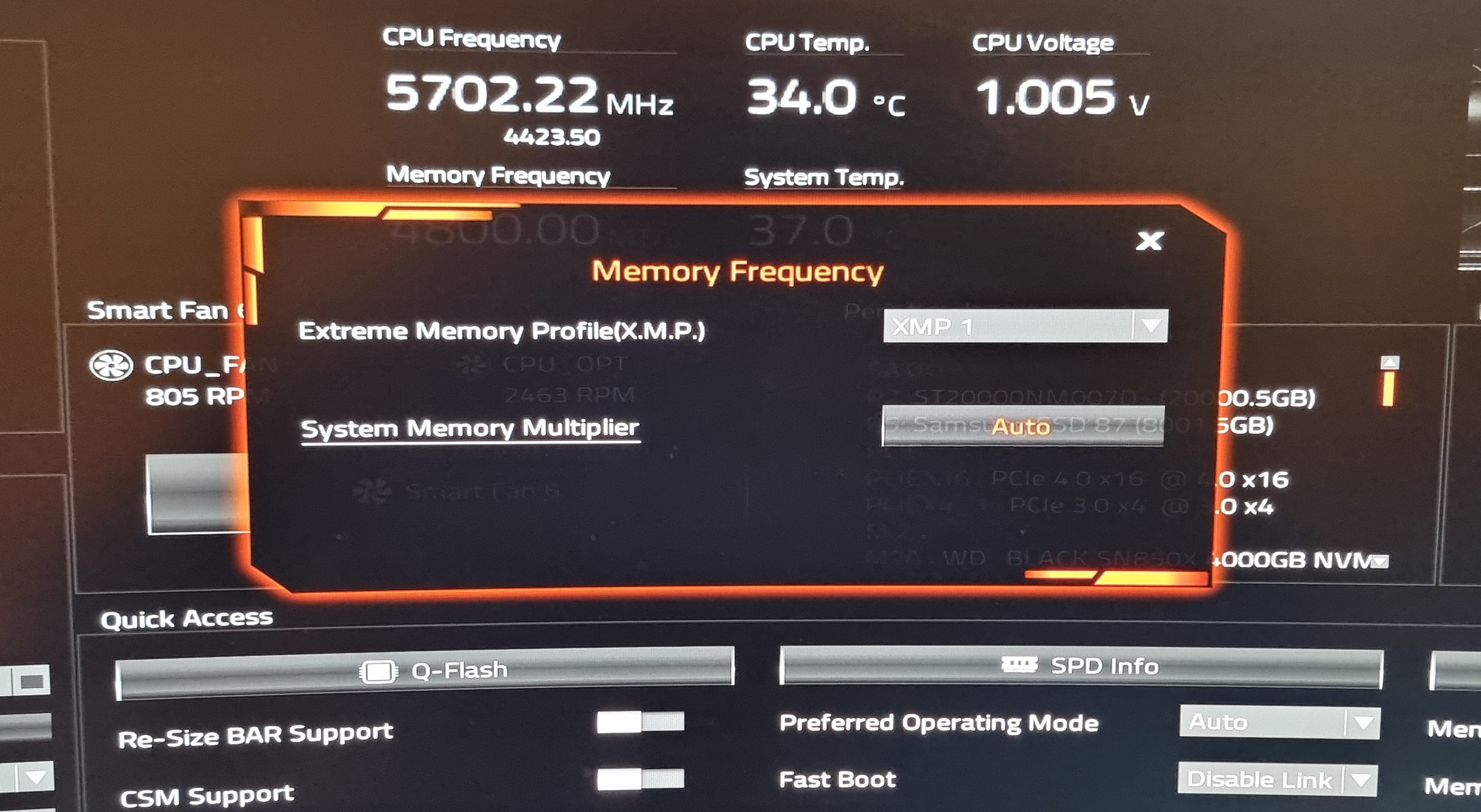

try setting xmp then changing the speed of the memory to 5200 and go up from there until it crashes then go backwards 1 step? try 5200,54, 56, 58, 60, 62, 64 as it clearly doesnt like 6600(you may have to swap to advanced mode in the bios for it)

I have to disable, otherwise the system doesn't boot. Yet this RAM supports XMP....well, it stays on the box :D

you can use something like hwinfo64 to monitor these voltages or even check memory voltages in the bios - just check that its set to the same as what your xmp voltage is if not thats your issue, ive had a board in the past when using xmp settings completely ignore the xmp voltage and use the stock voltage which results in unbootable system.

Got it stable at 5800 with XMP enabled. Above that memtest will show errors. Which is fine by me, better than the 4800 default speed :)
