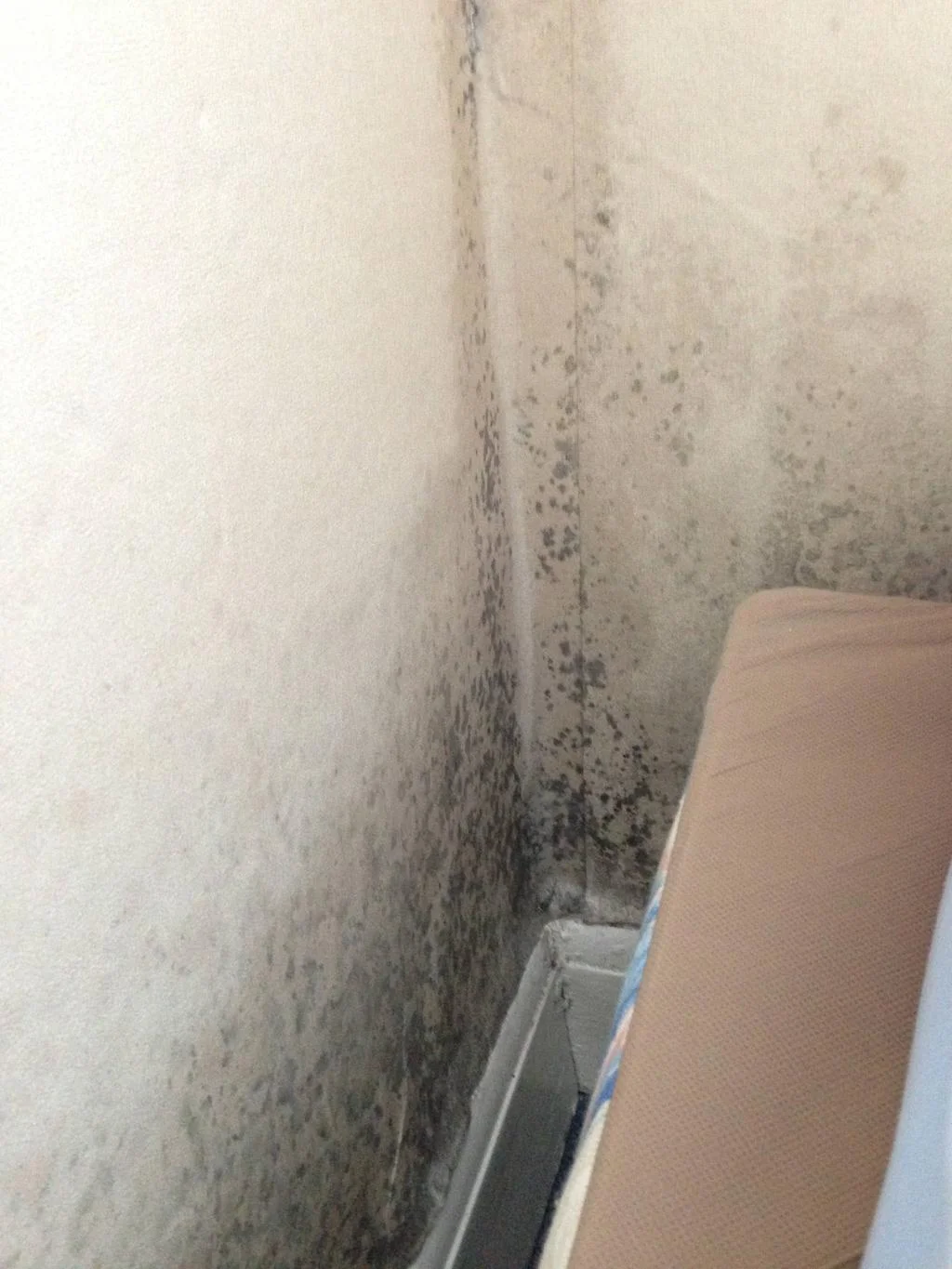

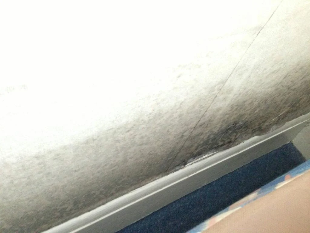

In the last week the corner (two exterior walls) of my room has gone from dry to a sprawling mess of damp and muck. The wall gets wet regardless if I'm in the room or not and is progressively getting worse. There's little I can do about the gap between the wall and the bed but I thought 3 inches would suffice? I've also been washing the walls down with warm water and a touch of bleach but it's doing nothing.
Nuke it from orbit etc...
The house was made in the 20's so no cavity insulation, outside wall, the room has lime plaster and I think the problem is exacerbated by the anti damp paint used (http://www.wickes.co.uk/invt/600317) and wall veneer (http://reviews.homebase.co.uk/1494-en_gb/072492/reviews.htm) used to even out the walls.

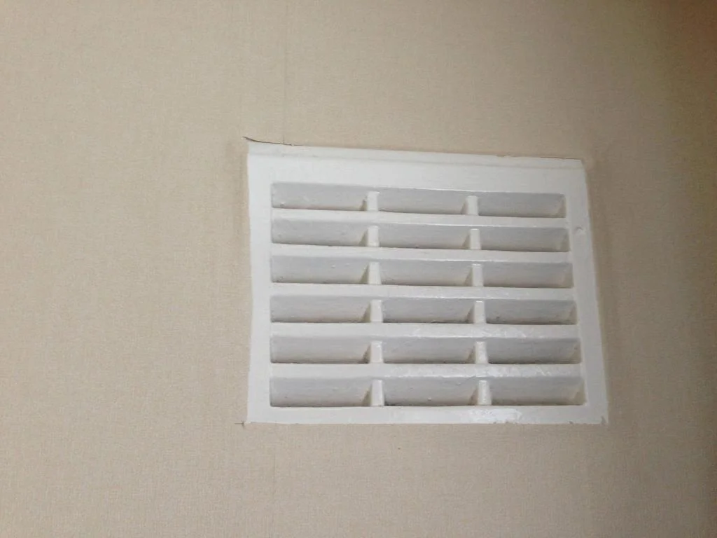

I also have a wall vent at the top of the room but I think the various crap on the wall is stopping that corner from breathing because if I peel the paper/covering back the wall is clean and free of stains.

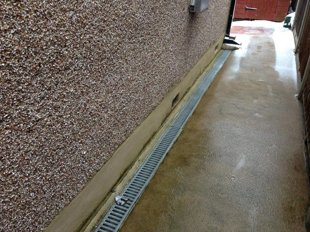

The side of the house has very good drainage and the same corner downstairs has no such problems.

In the interim just keep washing it with bleach and drying it, move whatever furniture is against the wall away and make sure there is some ventilation in the room, check there is nothing up against the outside wall directing water on to the wall or an air brick has become blocked.
That damp looks too aggressive just for condensation. I suspect that water must be getting in somewhere. Can you move the bed during the day to run a dehumidifier?
that looks like condensation: created by a difference in temperature inside and outside
hot air goes to the cold part of the wall , usually corners and converts back to liquid

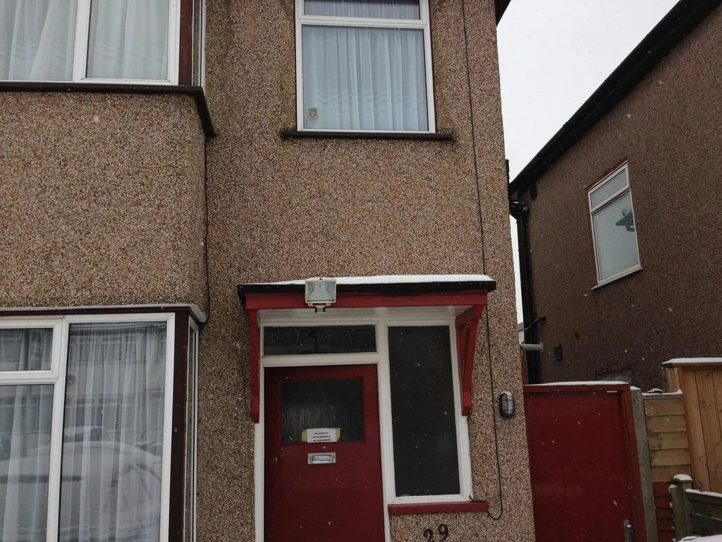

There's an old wooden porch at the front of the house, seems to be fine but it could be the snow against the wall melting and coming through the brick.

those vents are not much good as they dont pull / push any air
at the minimum you need extractor type fans in more than one room which are always on, if the problem is really bad you need a system which sucks air from outside and pumps it into the property. this causes a constant movement of air and the problem is cured. (though they are not cheap)
