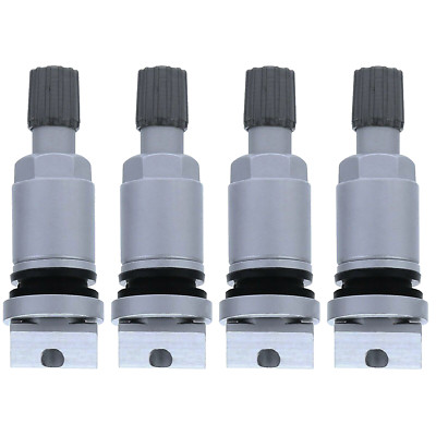

If TPMS valves are moved across wheels, new gaskets should be installed. The gaskets eventually under heat completely meld to the wheel and can't be used on a different wheel.
Entire repair kits are dirt cheap. I moved around valves across sets of wheels and would have slow leaks, especially in the cold where the rubber is more brittle.
Genuine Continental (BMW oem) ones are a bit more
