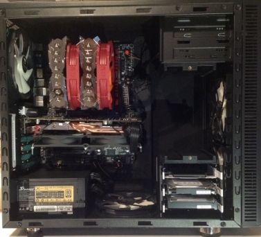

During gaming the ambient temperatures inside my case are rising up to 34°C, which doesn't seem all that ideal. This is the present layout of my case. Red arrows are showing warmer air, blue showing cool. (ignore the fan orientation vs my arrows, as things have moved slightly since i took the photo. The arrows are correct)

Of course your case is getting hot while gaming! Your bottom radiator is pumping all the hot it is radiating into the air your bottom fans are drawing into your case!
Turn them over and things will cool off.. and try switch your back fan to an intake too after you try just turning the bottom fans. Might lower temps even more. ;)
This is how it was before:
Case temperatures were still in the 30's back then. I asked about it and got told to swap the fans around to the way they now.
Cool air in, hot air out.
Hot air in, hotter air out.
Pump setting on your fan isn't helping either.
I'm betting if you reverse your fans again and raise your case so you have 50mm clearance, block the front and window side so hot air from bottom radiator is exhaust our the other side (so it doesn't mix with front and side intakes), your temps will go down.
The first rule of cooling is to keep heated air from mixing with the cooling air. Every degree you raise the cooling air temperatures raises your component temperatures
Edit: That's things you can try for free. ;)
Flipped the lower radiator fans and my case temperature is now 28.2°C in an ambient of 24.2°C whilst idle. It has dropped slightly, I'll have to play some games for a while to see how it has affected load temperatures. I've left the rear fan as an exhaust for now.
4c warmer in case than room is not too bad. Hopefully you can get that down another couple.
You have 5 exhaust and 3 intake. Reverse the back exhaust to intake. That will balance your air intake to exhaust.
