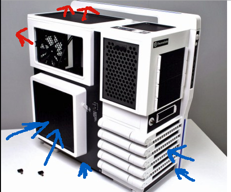

Airflow is currently this which I can't see any other way to improve

Looks good to me.
Any difference in number of fans and cfm ratings between cases?
Obviously you are not overheating. But would be nice to figure out why temps are higher now than before.
