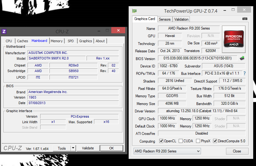

I'll throw in an update as I tried something different - connected the card to my old mobo and lo and behold it works fine there. So in short - new mobo works with my old 6970 and old mobo works with r9 920. If anyone has any ideas I'm all ears =/.
Final update on this issue. Catalyst 13.11 drivers kind of resolved the issue in the way that I'd get image after around 30 seconds - 1 minute and only once windows loaded up (that's only using HDMI cable, DVI remained non-responsive). However soon as I logged into any user profile and processes started loading up, the system would freeze up (only switching the PC off through the power button did anything - not even the reset button responded).
This made me adapt a different approach, I set the system to a clean start and downloaded catalyst 13.12 drivers. Since then, with only catalyst suite and my antivirus loading on start up there is no freezing issue and I get image on both HDMI and DVI connections, HOWEVER regardless of which connection I use I can never get any image in the bios (it only appears soon as windows boots up).
I'll stick to that for now and hope that eventually there will be an update that lets me access the bios, but in the mean time if anyone else has issues similar to mine I hope my experience helps them out.
