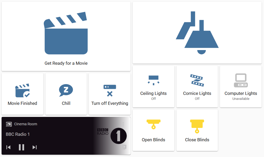

  • Wall mounted tablet showing Home Assistant cinema control screen
  • One button press on tablet that "Gets ready for a movie" by doing the following steps...
    • Turn on all the AV equipment
    • Start closing the blinds
    • Turn off the main lights
    • Turn on the LED lights
    • Start the Perl and Dean music through the SONOS in time to finish with the blinds closing (https://www.youtube.com/watch?v=3WQrLuaMBMw)
    • Start Plex
    • Start the "Amaze" Dolby demo (handy to run to tune volume based on audience preference)
    • Turn off the LED lights in time with the Dolby demo finishing
    • Shows a "royPLEX" logo :D

Home Assistant Screen for the tablet:
