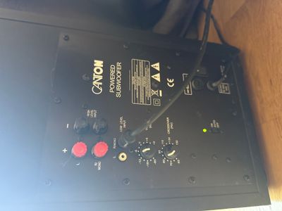

On the sub, it’s a canton powered subwoofer from my previous system that I’ve kept as it fits where I need it. It’s connnected via mono on the low level input to the AVR, crossover set to 80hz which is also set as the crossover under the LPF to LFE setting
No you want the bottom dial all the way clockwise. You'll need to do AVR setup again.
If your AVR has a option for low pass for the sub, set that to 120hz
Also when the AVR shows channel level for subwoofer you want that around 00db. If it's -12db or +12db (extreme range) you need to adjust subwoofer gain knob to compensate and run AVR setup again.
Ok so bottom dial for crossover is all the way to the right now (150hz)
I’ve changed the LPF for LFE setting to 120hz
Changed subwoofer to 0db
Gone through all the setting changes (I think), re-done the setup with my sub as per the photo
Audyssey recognised the 5.1; calibrated everything but got the AVR showing -12DB for the sub level
Do i need to turn up the gain on the actual sub to change this to get closer to 0DB?

Not 100% sure on the sub question as I still need to buy myself one! But I think if Audyssey set your sub to -12 dB, the gain on the sub is too high. The subwoofer was likely too loud during calibration, and Audyssey ran out of room to turn it down.
Turn the subwoofer’s gain knob down (around 10-11 o’clock), then rerun Audyssey. You want the final trim to land somewhere between -6 dB and +3 dB. -12 dB means Audyssey ran out of room to turn the sub down.

-12db on the AVR means the volume control on the subwoofer itself is too high, you need to reduce it on the sub.

Thanks, changed that and also adjusted the gain on the sub to the 10-11 o’clock position. Reran setup and came back at -4db
