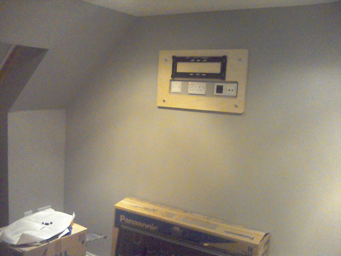

And nice job there, although I do wonder if that red light may be a little annoying at night? :p I assume that plug has a built in surge protector?

I've actually been looking in to surge protection plugs since your post. It's a good idea, I think I'll stick one in the AV room and one or two by the TV for larger draw equipment. The rat in planning on attaching to a surge protecting extension cable.
