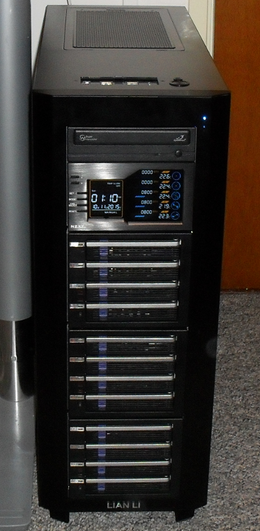

There's really not much with exterior facing swappable bays. Believe, I looked when building my own. I ended up buying a Lian Li PC-A79 because it had 5.25" bays all the way down the front and then I stuck some HDD hotswap cages in it. Would have been cheaper to buy a rack case. But then I'd have had to buy a rack cabinet too.
The other one I had was a Zalman something I've forgotten the name of. It was MUCH cheaper than the Lian Li, but it required cutting tabs off the inside of the case to get the HDD cages to fit. It was an absolute nightmare and scratched one of my caddies to pieces. Airflow was crap too and cable routing was non-existent. So I threw in the towel and ordered the Lian Li (as I already had all the cages anyway).
Mine as it stands now.
This is for most people, complete overkill. But I like playing with Linux / Unix and server hardware.
If I were you, and I wanted quiet, I would go with the Fractal (which I also have one of). It'll take 8 HDDs, two optical bays, there's two SSD mounts on the backside of the motherboard tray. Cable routing is pretty good. The only reason I didn't use it was I added MOAR DRIVES! Sure, it doesn't have externally facing swappable bays... but how often are you actually going to be IN the case? The only reason I have the caddies is because I play around with ZFS and BTRFS and I'm frequently pulling drives.
