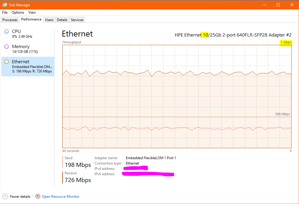

Just as an example, this is my work CCTV Server - it has 131 cameras recording, as well as however many users viewing footage - it rarely even reaches 1Gbps bandwidth usage - If you've only 8 cameras I doubt you even max out 100Mbps
