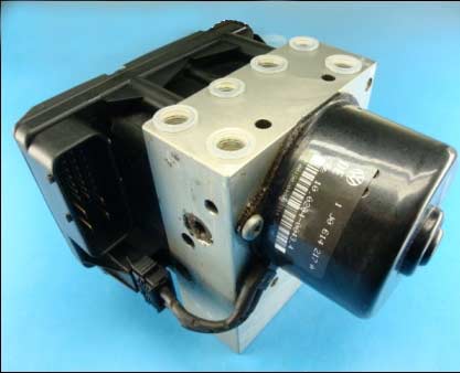

pump looks something like this
places on the net repair them for around £400 with a 2 year unconditional warranty, best check them out if honda don't play ball.

The ABS/ESP units with prolific failure rates of the pressure sensors fitted to VAG cars (and others) are ATE Teves MK60 units.
It sounds like this is the same problem on the Honda. If its the MK60 you can fix these for about £150 plus the labour to fit the replacement module.
I'm not aware of any common issues with Bosch units, but as with anything you'll get some failures. Talk to BBA Reman if its a Bosch unit as they'll probably do a refurb service.
That's quite a thread bump!
Like Blueboy has stated one of the pressure sensors failed, Honda wouldn't play ball, we took the pump off, sent it to BBA Reman and all has been well since.
