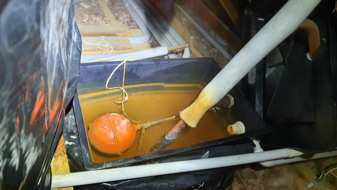

It's coming from the smaller of the two tanks in the loft... I've lifted the lid to have a look inside in this picture...
and inside looks like this...
I was expecting the problem to be the float valve, as I had to replace the float valve in the bigger tank last summer when it started constantly dripping, leading to a constant overflow drip.
This time, it's the small tank (heating/hot water expansion tank?) and it's not the float valve - that turns off completely - but rather the pipe coming into the tank from above is pumping hot water into the tank when the heating/hot water system is on. The water in the tank was quite warm and causing condensation on the outside of the cold water tank next to it.

IIRC that smaller tank is normally the header for the central heating, basically allows for the central heating water to have somewhere to go when it expands if it's not a combi boiler, and allows it to automatically top up if say you bleed the radiators (modern combi boilers use a sealed expansion vessel to allow for the expansion, and a manual feed tap under the boiler to do the job of the float valve).
I'm not a plumber but it might indicate there is air/a blockage in the heating pipes causing the water to back up when the circulation pump is running.
Basically it's for the radiators, so go round and check for any signs of cold radiators to give you an idea if there is a blockage.

Looking at the pictures of the inside of the expansion tank, there is a lot of, what I believe the technical term is, gunk in there - is that expected for a system this old?
Or is it indicative of a gunked up heating system?

It looks like it could be limescale build up. This is probably what has caused your failure, the build up has caused a valve to stick or as mentioned above, a switch motor to fail.
Your heating would probably benefit from a flush and addition of inhibitor.
The small tank is the radiator header, so if you're getting hot water returned to it that'll be gunk from the radiators, or possibly the heating coil in your hot water tank (the boiler in this sort of system normally heats the hot water indirectly by running heated water through a copper coil that indirectly heats the water that'll come out of the taps).
As radderfire says emptying the rads, flushing them and refilling with an inhibitor would probably be a good idea at some point, it's not normally too hard to do yourself but can be time consuming and something best done when it's warm enough you can hook up hoses to the drain points (there should be several at the low points) and run them out the door to a drain, then when you refill you want to open the bleed valves on the highest radiator.
