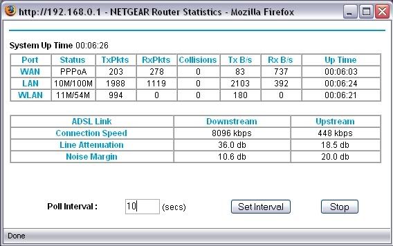

What about my line with ADSL2+? Currently on ADSL Max with Zen and i sync at 8128/448.
My stats again....
Attenuation
Downstream 15db
Upstream 7.5 db
Noise Margin
Downstream 10.2
Upstream 24.0
Coolasmoo said:
Connection Speed 16681 kbps 1313 kbps
Line Attenuation 30.5 db 14.0 db
Noise Margin 6.1 db 6.9 db
Nice, that's a pretty good speed for a fairly high attenuation. I'm looking forward to moving into my new place - cable is installed and it's literally metres from the exchange - mate who lives nearby has an 8dB attenuation. I then just have to decide whether to stay on Virgin cable or go to Be, Bulldog or Sky - all LLU options are available at my exchange :)
Yeah, Im only about 1km from the exchange so i can only think that my line goes around in circles before it gets there.
Those stats are from Be* with an ADSL filtered faceplate and a DG834N
