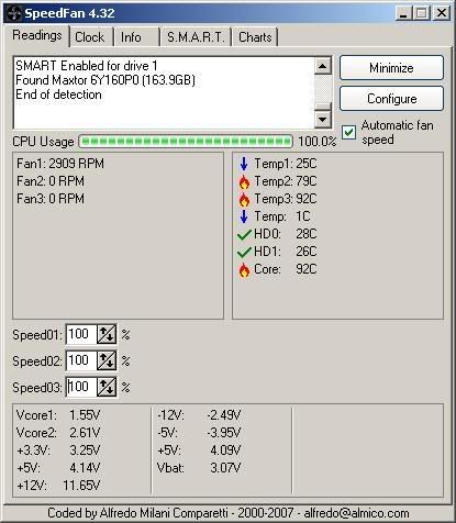

hmmmm, i think its running a little hot:
edit:
Temp3: 102c
Core: 103c
Is this even safe??

Don't know its been a while since i attached it. I seem to remember there being some pink stuff already in place. The Core is now at 110c... maybe the readings arent accurate. Either way i guess this explains why leaving the side off the case didnt help much!
edit: just burnt my finger touching the heatsink... i guess it is actually hot.

as edit above: I touched it and it is hot, i burnt my finger doing it. Would it get so hot if it wasnt seated properly? 115c atm.
ok, i thought speedfan might not be accurate so i rebooted and went into bios. It was indeed running at 106c! I noticed cpu warning wasnt on so i enabled that and now it wont boot (obviously). I don't think ive messed around with voltages etc but ill try your suggestion. Im using a gigabyte k8nspro (or something like that)

I've opened her up to get a proper look and there appears to be a thick layer of dust beneath the fan... Im gonna try cleaning that up and resetting cmos to see what happens.

Right after i removed the dust (there was LOADS!) i discovered i had a spare heatsink/fan so i just swapped that in. It looks like its never been used. However the computer wont boot now, im guessing its to do with the cpu warning i enabled in bios so i guess i just have to wait it out.
Im putting the temps down to the fact that the fan wasnt actually shifting any air due to the huge carpet of dust... i'll let you know the results when i can turn my machine on again :P
