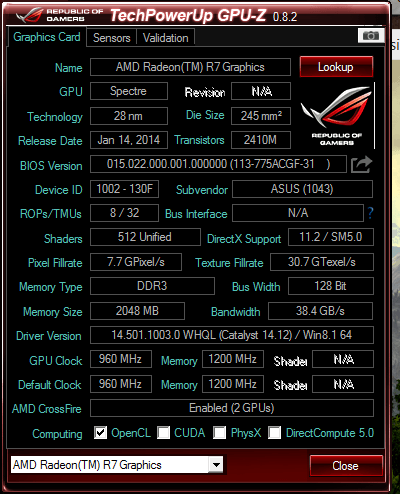

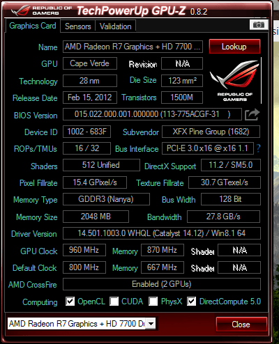

Could you post a screen of gpu-z showing that crossfire is enabled? It's not officially supported, so I think the 7750 is just running on it's own.

I'll do that when I get home. And yes, it isn't officially supported, but it does appear to work (as have other cards in the past that weren't officially supported from what I've read.)
As above, get a screenshot of GPU-Z for both the 7750 and IGP. Are you sure the IGP is running at 1028MHz? On the AMD site it states it should be running at 720MHz, unless you somehow overclocked it: http://www.amd.com/en-us/products/processors/desktop/a-series-apu

GPU-Z:
HD7750
7850K R7 APU (iGPU)
