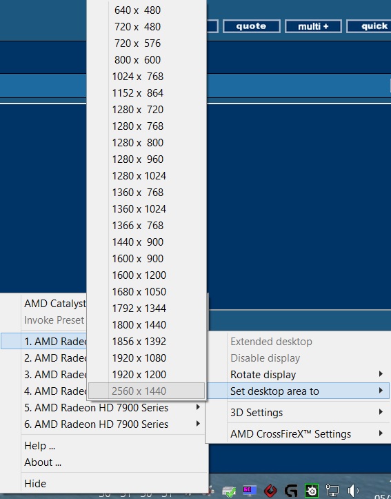

Right click CCC icon then...
This is the problem I am getting
I get the same thing with NCP, there is no option for 1440p but it allows me to create a custom resolution.

I think the problem is HDTV only goes up to 1080i so CCC won't let me set a higher resolution, only a lower one.
I also think part of the problem is my monitor as I have always had a problem running 1440p whether I am using NV or AMD. Even if a program like Heaven 4 offers an option to run 1440p, once the program or game starts it will default back to 1600p. I don't have this problem with any other resolution only 1440p.
With NCP I can make a custom 1440p resolution and then it is available to set in windows which in turn allows me to set and run it in the program or game I am running.
I don't think the fault is with CCC, I think it is one of those quirky Dell things.
The only way to do this is with a registry hack (which you will lose every time you update your drivers).
http://hardforum.com/showthread.php?t=1605511
