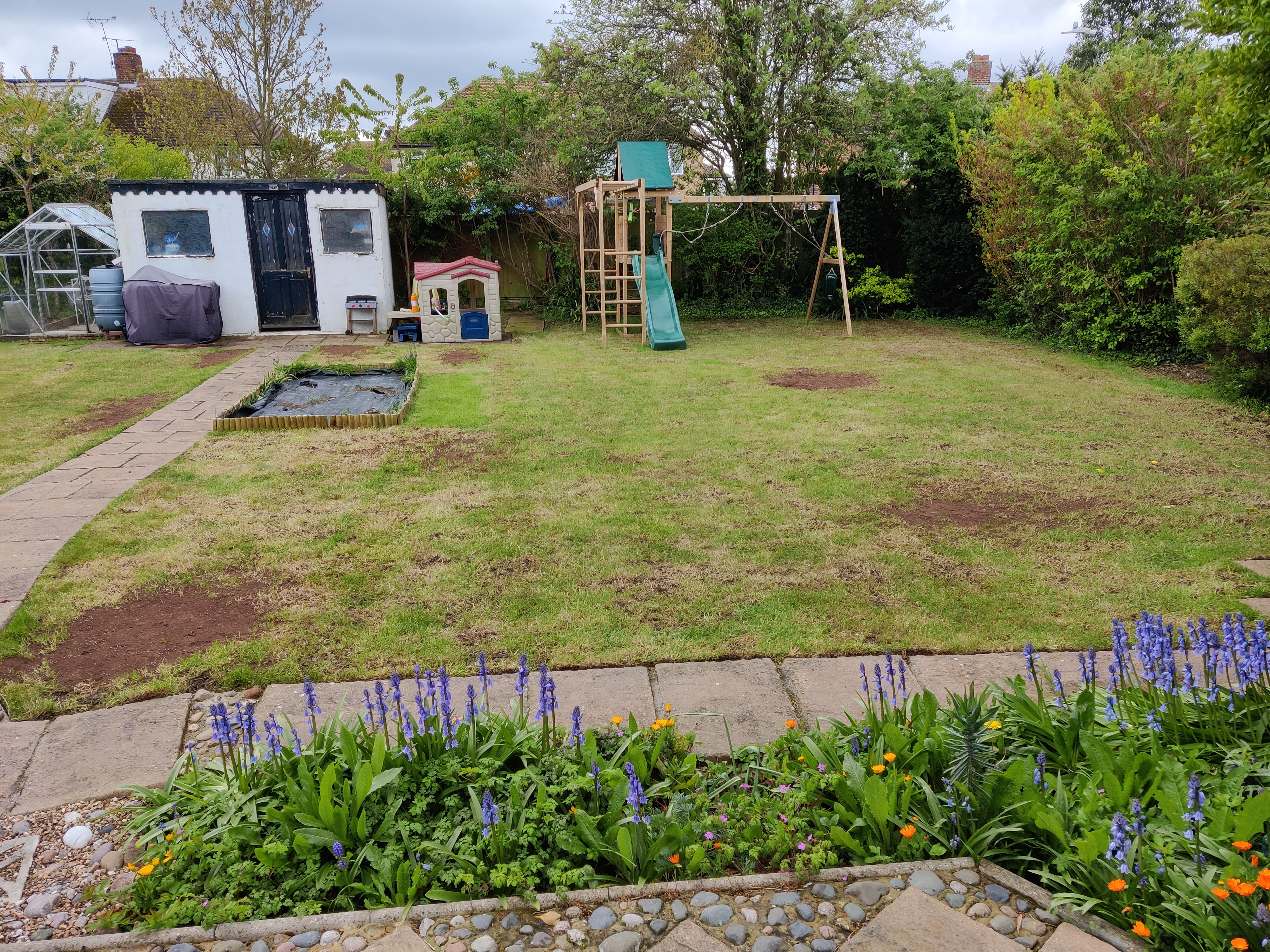

I have provided some pics of my current lawn - my idea is to "top up" the current lawn.
Do I need to remove all weeds seperately also? a lot of the green is weeds...

It will look worse before it looks better I hope! This is where I am at the moment, I've not watered it as its due to rain for the next few days.
The biege bits arnt dead grass, well, there is a bit as i'm lazy but mostly its a mixture of sand, compost and grass seed.

I just took these pics of my garden at this stage, next week is overseeding and more levelling then praying it takes
