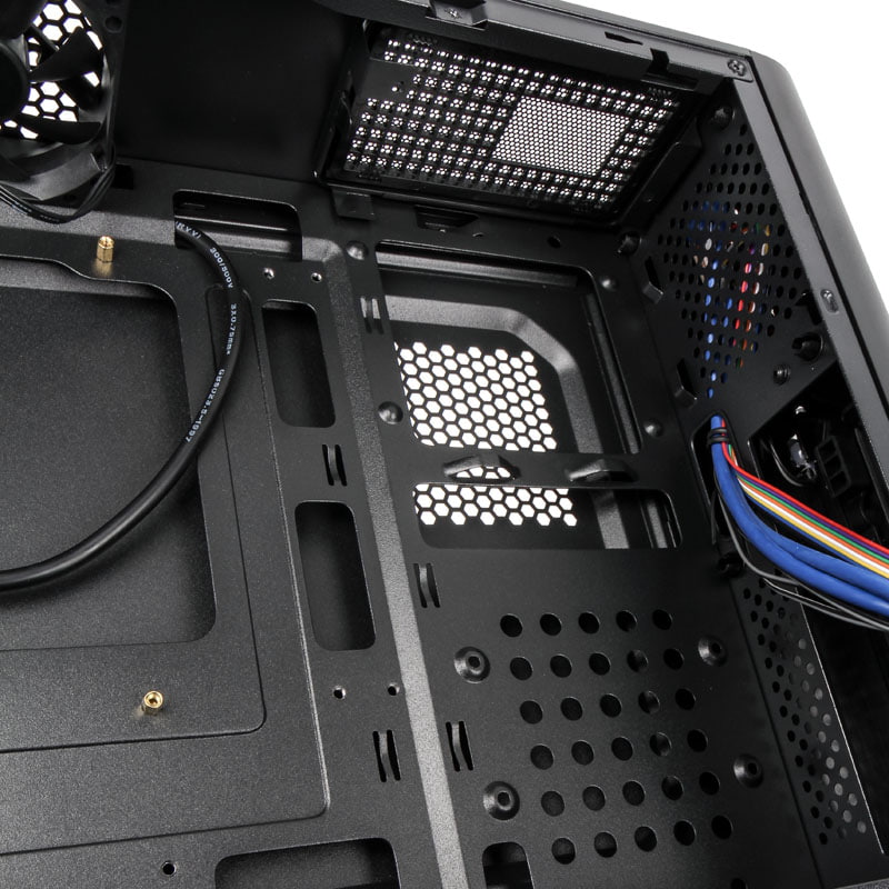

How does the PSU fit in the Aerocool CS101 Micro ATX Case?
Looks like the PSU would go in the gap on the top right when looking at the case from the open side on (think where a optical drive would go on a normal ATX case). I assume there is a internal power extension cable to get the power from the port at the back into the PSU itself.

as above as well, the psu on top right and in the image below you can see where the psu fits in and the power extention cable
