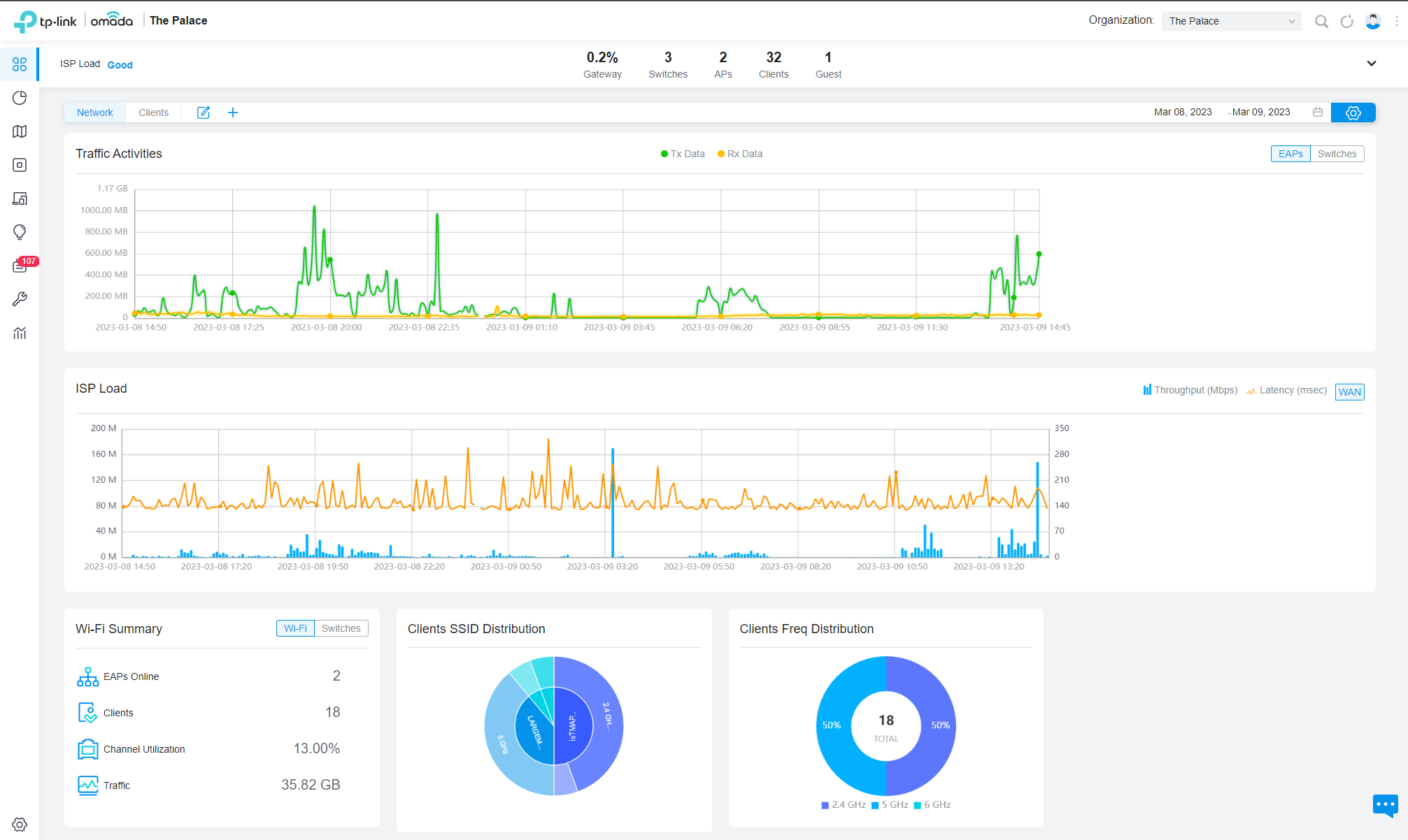

A good compromise in keeping things simple, with lots of tutorials would be to go SDN (software defined networking), since you mention Ubiquiti, you could get their stuff.. I have the TPLink equivalent (Omada) and have put my Superhub in Modem Mode and have:
- TPLink ER7206 Router
- TL-SG2008P Managed 8 Port POE Gbe switch
- TL-SG2210P (x2) 10 Port + POE Gbe managed switch
- TL-SG2218 - 18 Port Managed Gbe switch
- EAP 620HD Wifi Access Point
- EAP 660HD Wifi Acess Point
I've setup VLANs and segregated networks throughout the house, which sounds complicated, but you can follow tutorials on youtube, so I have a Management , general devices, IoT and Guest Network, so ensure that dodgy WiFi christmas tree cannot compromise trusted devices/networks.. And all the consoles work well together, all get a fully open NAT status and have been so reliable.
Of course, you could stick with individual APs and not use any 'managed' complicated setup, but I love the control and 'simplicity' in that you configure it all from a single front end which will propogate rules/settings automatically to all relevant devices.
