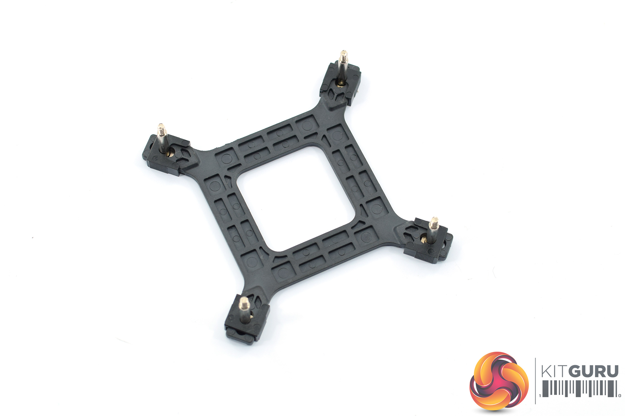

I'm building a new rig for someone and it's been a while since I've done a build.
The motherboard is a mini ITX Phantom Gaming from ASRock.
And this is the Heatsink....
According to the manual for a stock cooler it looks like its got those plastic screw clips which twist and lock underneath the motherboard.
Help please!
Ah crap I think the backplate is still on the motherboard that got sent back which was DOA.
Actually I think it's this one
Hard to know which one to get but the one in the picture above is the one from a review of the Cooler so I'm guessing that's the right one, ordered it so will see when I get it.
Well I should have spoken to them first but I just spoke to UK Coolermaster support and they said send the serial number over and they'll send one out for free. Very good of them.
