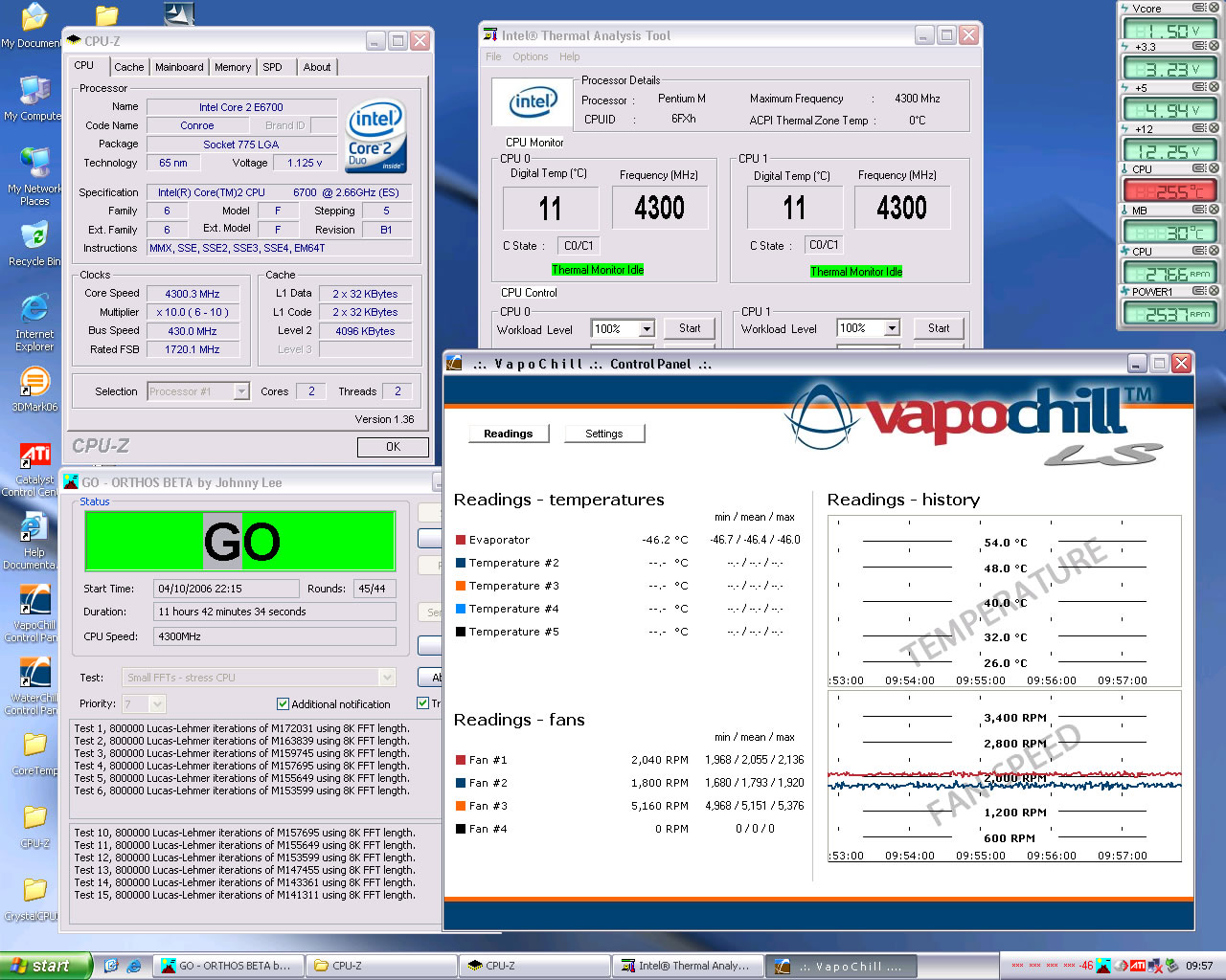

This is what I've got so far, just wondering if its ok to cancel Small FFTs now..
(sorry for huge pic)
I would class the cpu as stable with that m8. It could fail 1 minute after you stop it or it could fail 24hrs after you stop it. Personally I reckon thats ok.
Test Large fft's now - usually the hardest test to pass tbh.
Thanks, that's what I'm doing now. :)
