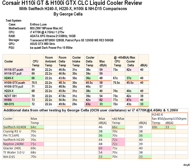

The reason some CLC users see a temperature drop is not because of cooling ability, but because of massive difference in airflow and the fact the CLC is using cooler air.
The difference in airflow is why they are so loud. The cooler air is because most users do not 'tune' their cases to optimize their performance. Every degree warmer the air is going into cooler / radiator translated into CPU (and/or GPU) running about the same degrees hotter.
This graph shows the cooler / radiator intake air temp and the room air temps. notice the difference. But the difference between air and CLC intake temp in this test system is skewed / abnormal for some reason. Normally air temp into air coolers is 5-10c warmer than radiator. Also George always mounts CLCs as exhaust, never as intakes. The same testing with CLC as intake would lower CPU temps by about 8-9c .. the difference between room and case air temps .. but at the cost of making the air inside of case about 10c hotter .. meaning in a 22c room the air cooling component would be no lower than 42c. Cae would be heating some components, not cooling them.
Georges%20data%20w%20all%20coolers_zpscmcly46l.png~original
