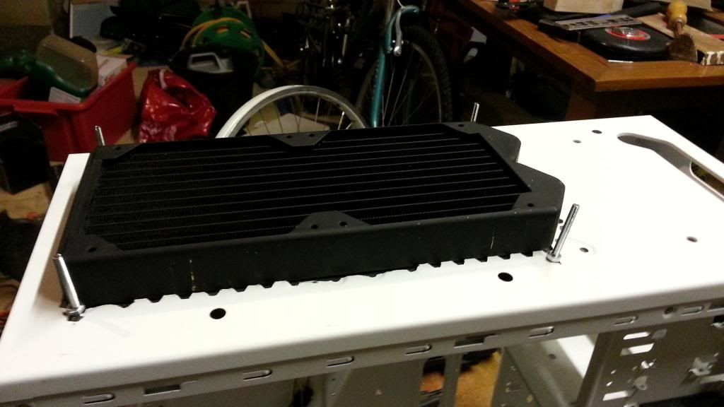

the shinobi is VERY limited for watercooling, I shoehorned 2 240mm radiators into mine, but it involved removing most of the top panel (and sitting the radiator on a suspended grill!), and removing the hard drive cages (I now just have two solid state drives velcro'd behind the DVD bay)
pictures in here:
top view of suspended rad
bottom view
front rad was slightly too big, so the bottom of the drive bays had to go as well!
everything hosed up and filled, but not fully cabled up yet (during leak test)
