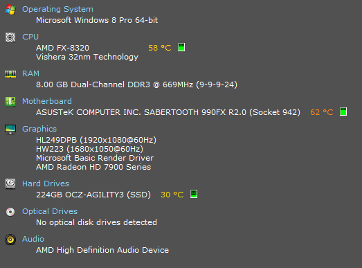

Here's my temps after 10 minutes of Prime Blend. At 1.4vcore, think it's worth trying to push higher with these temps?
Is the 58 CPU socket or core temp?
Core temps are what you want to focus on (download CoreTemp), anything up to 63 is good.

That motherboard temp looks high to me, is there much airflow in your case? Mine rarely goes over 42c and idles around 30c not sure what rated max is but it seems high at 62c
It might be worth trying the same tests with the side off your case to give you an idea how much lower your temps would be with decent airflow
Currently I have a 120mm sickleflow in the front of my case, a 120mm sickleflow in the top of my case along with a 140mm aerocool shark fan, a 120mm sickleflow on my CPU along with some molex 120mm Zalman fan on the other side of my cpu cooler. No exhaust at the moment, maybe that'll help cool my VRMs?
