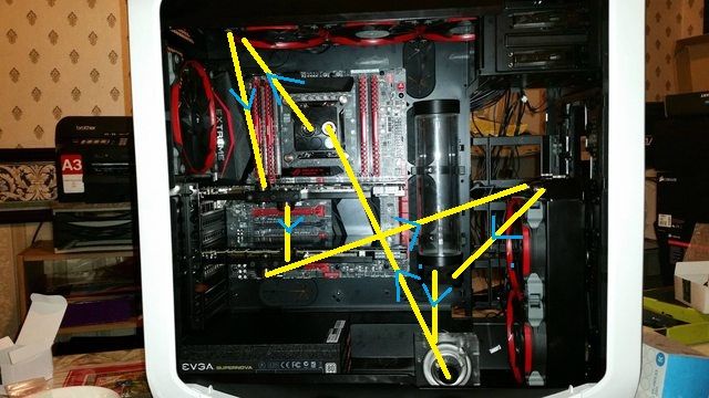

How should i set up the loop?
8 Sep 2014
27
attachment.php
If you have anyquestions plz ask. There is a rad at the top. You can use paint to show. There are 2 fittings for each part. Fittings for 360mm rad are on the left.
Not clear if you have a rad on the rear case fan or not?
If not, my suggestion would be Res>pump>gfx>gfx>top rad>cpu>front rad>res.
Probably be easier if you turn the top rad round so the hose connections are at the rear, then it's a smoother run from gfx to top rad.
From the Res to pump to front rad to gfx cards top rad then cpu back to res i see a clean loop that way.
Are you using rigid tube? The fittings do look like it but not 100% sure
Don't bother alternating blocks and rads; it won't make a difference and the loop will be more complicated than it need be. Just go in a circular route. Anticlockwise tends to be the simplest as the gpus are on the left and the reservoir and pump tend to be on the right.
Go res-pump then front rad then up to the top rad then down through the cpu and gpu blocks. Nice and neat!
Just put it how you had it before, just switch the res outlet to the pump inlet this time. that is all you di wrong the last time, and you know how to do most of the rigid tubing cuts/bends you did before.
