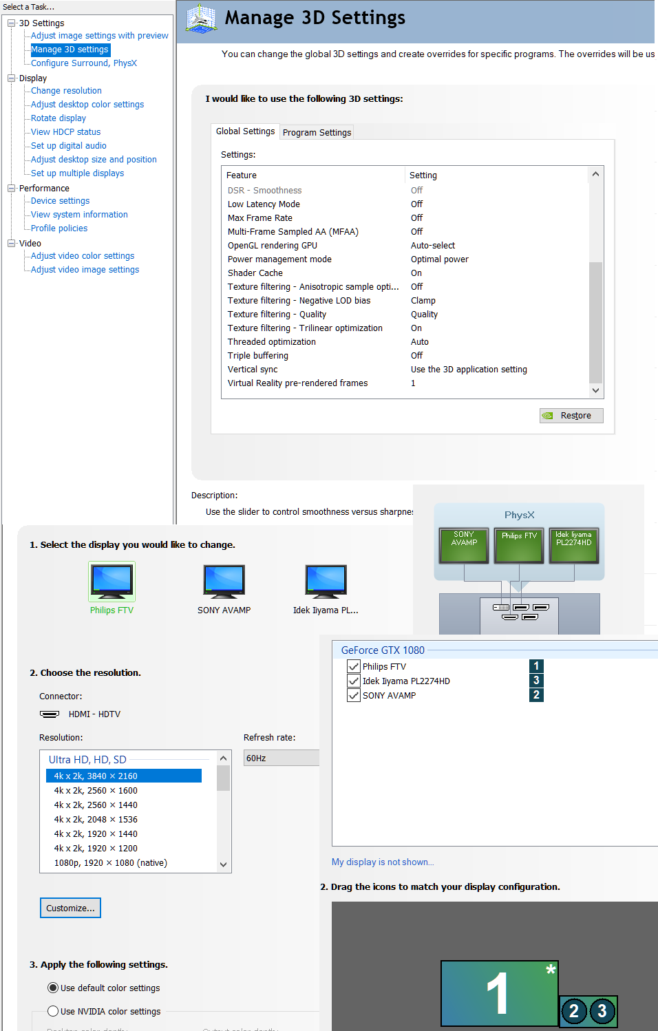

It's just there in the Nvidia control panel "Preferred refresh rate"
I lack this setting, this is my config:
