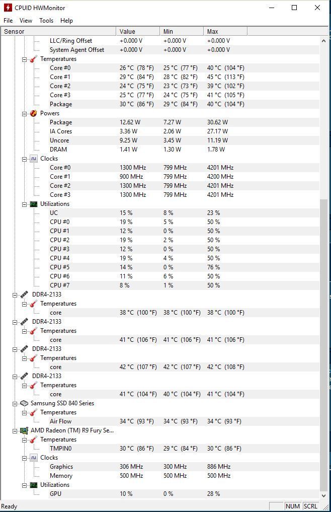

I've got the pwm fan hub in now, and every fan going is effectively controlled by the CPU fan header. It works better than I could have hoped. The system is very quiet until the components hit about 60 degrees, where fans start to ramp up gently with a more noticable step up in the 70s. After a couple of hours of Witcher 3 it seems that's where the temps stop rising, and even there it is a lot quieter than before. I'm comfortable trading off about 20degrees in favour of low background noise.
I've also knocked the D5 Vario down to 2, cos it turns out I can hear 3 when the rest of the noise is quelled.
Cooling an [email protected], and 2 r9-290s@1150. I'm sure the temperatures will improve further when I replace those GPUs for something less toasty, and
