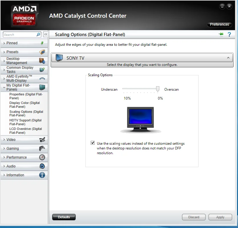

If you're connected via hdmi then install Catalyst Control Centre (if you haven't already) then My digitial flat panels > Scaling options > set to 0
You don't have this option in CCC?
i have 3 monitors and it all depends which connectors i use if i need to overscan to fit them all perfectly. so default after wiping drivers one is always underscanned. Kinda annoying
