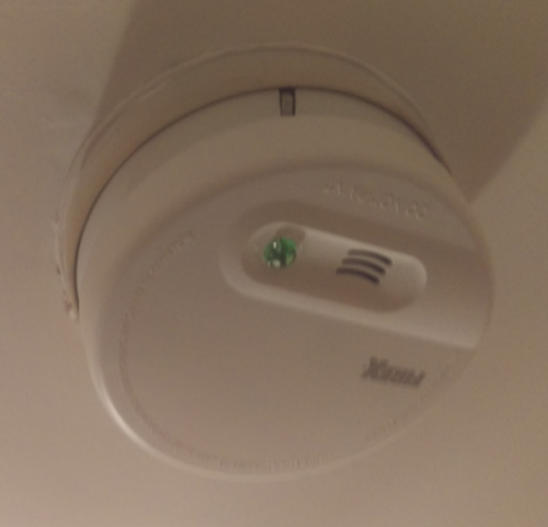

I have a Kidde smoke alarm with a non-removable battery. Last night it started beeping to indicate a low battery. When I try to remove the alarm from it's ceiling mount, all I can do is twist the alarm around one way and then back again. At no point in this twisting process does the alarm come away from the mount. I have tried pulling, shoving and everything, but the alarm will not come free from the ceiling mount.
Does anyone have any idea how to remove these things? I don't want to have a night disturbed by the thing beeping every few seconds.

Mine require a thin screw driver. There should be a niche on the rim. You need to depress the latch if yours is like mine and then twist.
The latch is at the top. Hope that helps.

It's off! It appears to have been stuck to the ceiling (the fire service put it up for free when doing door to door fire safety rounds).
yup they put one up for me few year back stuck it on with crappy adheisive pads it lasted four hours before crashing to the floor :p had to break out my drill and tools to do a proper job
