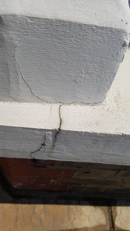

I want to repaint all the vertical and horizontal stone around the front windows. What would be the best way to do this and which product to use to make these cracks disappear before repainting? You'll be able to see from the close ups that the lower part of the window ledge had been repaired years ago when a lot of the stone had broken off.
There's masonry filler specifically for this sort of thing.
Youll need to remove paint, and any loose bits first. I'd probably score a small V where the crack is, so the filler has something to go into and bind to. Less likely to crack in the future.

I think the horizontal one might be a bit of a pain. Looking at the photo the way the light reflects off it, seems to show the repaired bit sitting a bit higher than the bit above it. I think filling that and sanding it to be level might be tricky.
Scrape them out before filling so the filler has more surface area to adhere to.
Thanks guys. That Toupret masonry filler looks good, I should imagine much better than standard polyfilla.
How do I strip the paint off? Or can I just sand over the paint to give it a key for the paint to stick to? I'm basically doing things up with a view to selling within a year (mortgage finished so swap my flat for a house outside london) so I only need it to last a year or two.

However, I've spent the last couple of days prepping the masonry. I washed it all down to get grime and cobwebs off and sanded the whole lot with 80 grit. No sanding machine, did it manually using a rubber sanding pad to put the sandpaper over. I've pulled away any flaking paint and sanded over that to smooth the edges. Even while it was raining today! I've bought a box of Touprelith F to fill cracks and I've scored the cracks with my filler knife to make it easier to fill.
I bought a tube of exterior caulk today and have just sealed the bottom of some of the window frames where they meet the horizontal sills and around the base of the verticals, because I had noticed narrow gaps. I'm not very good at it yet, I got a lot of excess sealant on the frames and the sills, so spent a lot of time wiping it away with kitchen roll and getting it all over my hands. :D There's still some more bits to seal.
Tomorrow, if it's not raining, I plan to use the Touprelith and then I'm looking forward to painting it all with Sandtex white. I'm wondering if I can fill the shallow patches where paint had flaked off, but I don't know yet how thin the Touprelith will spread.

Guys, do I need some stabilising solution to seal bare patches where I've taken loose paint off to give a thin layer of filler a better chance of adhering or will filler stick anyway? Areas like this
Or maybe I'll just paint some bits like that without filler and presumably that will need a sealer/primer? I'm thinking of buying this, what do you think. I believe PVA is the same as stabilising solution?
