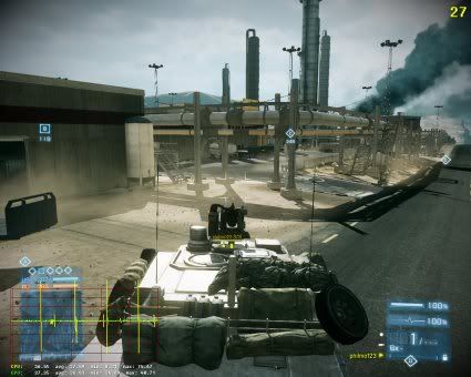

Further to my previous posts, I have attached images of the my screen CPU vs GPU usage in game. An the spikes seen are from the CPU which I would not expect, would be appreciated if there is any feedback to improve things.
I had assumed the GPU was under strain - but from this (using Low settings and low resolution) it seems the CPU is under presure.

Have you put the latest 12.x AMD driver release on?
It had good improvements in BF3. If you have one of those real dodgy switch able graphics setups like my Y460 then you are stuck using the official OEM drivers. These NEVER get updated.
However, there is a solution - I use the custom Unified ones from here, they might well work for your model/setup also:
http://leshcat.blogspot.com/
CPU throttling? What's the temps?
