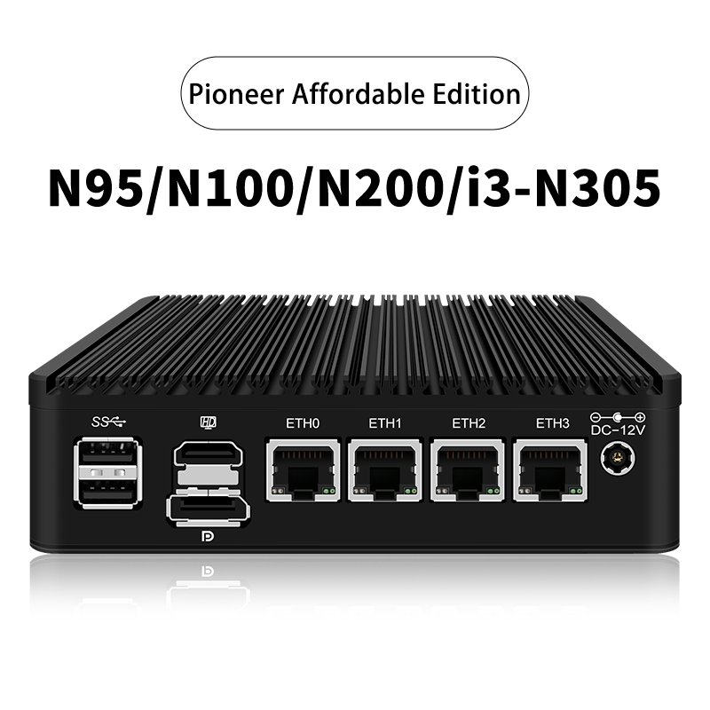

Right okay thanks for the help. They do look okay the Mini PCs something like this:
*** no competitor links ***
I may also look at an Elite Desk 800.
