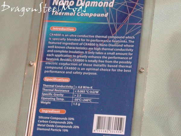

Thanks for the replies. In answer to both, I didn't put fresh paste on the CPU as I only removed the fan from the heatsink, not the heatsink from the CPU itself. So I have no idea if it would need re-pasting, would you recommend it? I do have some thermal paste laying about from when I had my old laptop, I am not sure if it's good for the job though, maybe you guys can help:
It is called Nano Diamond Thermal Compound by Jetart Ltd, CK4800. I believe this is it:
http://www.dragonsteelmods.com/Images/reviews/jetart-nano-diamond/resize/tn_jetart-diamond3.JPG
I don't have much left, but then I wouldn't need much would I? Would TIM Cleaner be OK to remove the old thermal paste?
Thanks

GOD no shes using far to much lol you only need a grain of rice size (as you have said) in the middle of the cpu. When was the last tim e you changed the thermal paste? if its been over a year or more then YES try it. that paste should be fine just remember to clean off the old paste on both the cpu and heat sink with your TIM cleaner.
