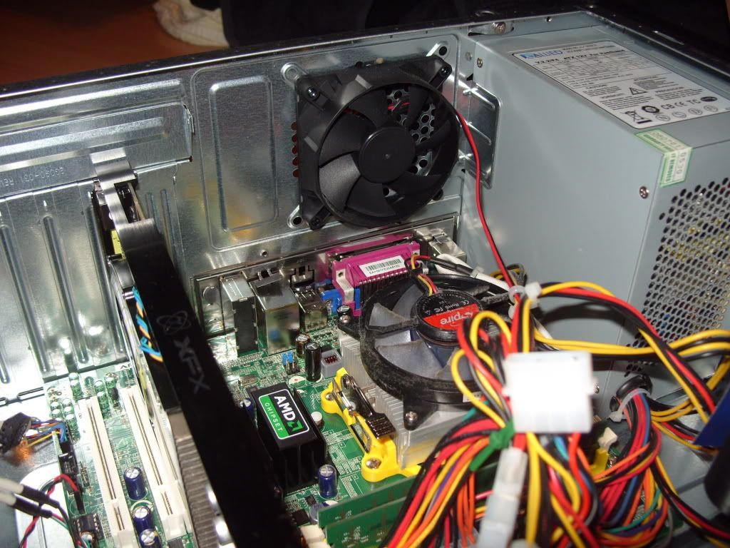

Sounds like you need to get your cooling sorted out...
Do you have a 80 or 120mm fan at the back of the case? which case are you using? do you have a fan at the front of the case?
The onboard soundcard was on auto on the bios so i put it to enable and it still doesnt work :(
I'll get a pic of inside the case as i'm not sure myself
EDIT here it is
I'm guessing 2 fans isnt enough
