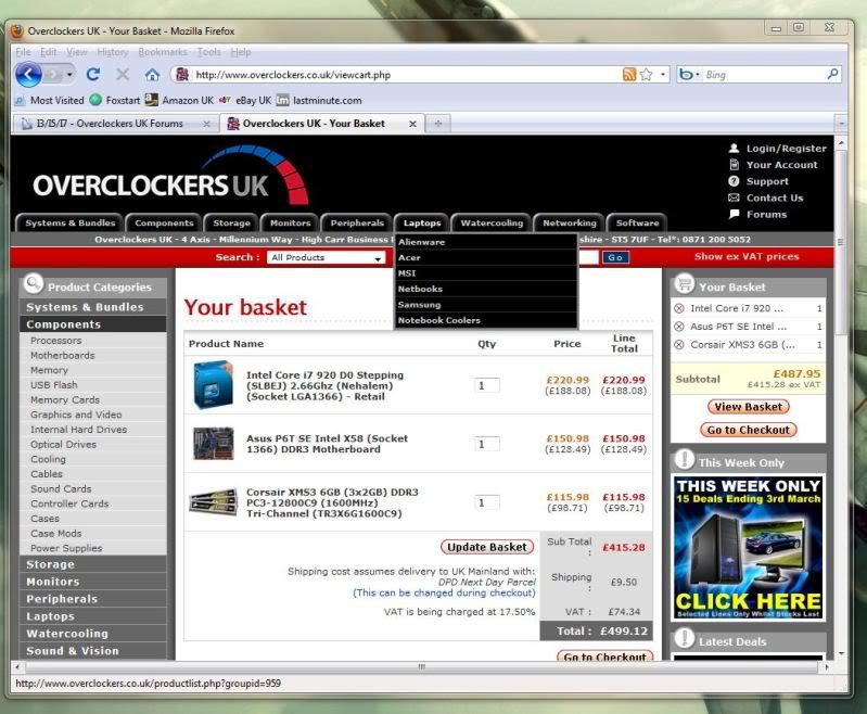

I have £450 to spend and would prefer I7 stuff what do you guys thing as i said i am well out of touch with pc stuff just lately.
Trouble is i added some prices up and i don't think you can get it for that money, could do with some input on mobo/ram etc really have no clue about I7.

Its looking like that listed below tbh, I hate pc's when you got the upgrade bug as it pulls you one way or the other, one time its I5 then i think i want HT on it for encoding etc so I7 haha, then its back to the 860 then back to I5 never ending circle, i want something that will do me for a good few years so i think the extra spent might be wise.
Will my H50-1 cooler be sufficient to cool the 920 i would like to get as close too 4 gig as possible.

In the end i went for this setup common sense came in the end, i was unsure over the board though as the Asus i had been advised to get had gone out of stock but a chap posted a review over this board saying he got 4ghz easy so made sense.
Probably not lol but I got them I guess, I don't mind the extra but I guess I could have saved that mone.
Great find i only went for the ud4 as i had been reading some reports of people having issues with the UD3 and when i read that review of someone buying it on this forum and hitting 4 gig on stock volts i thought maybe i get lucky.
