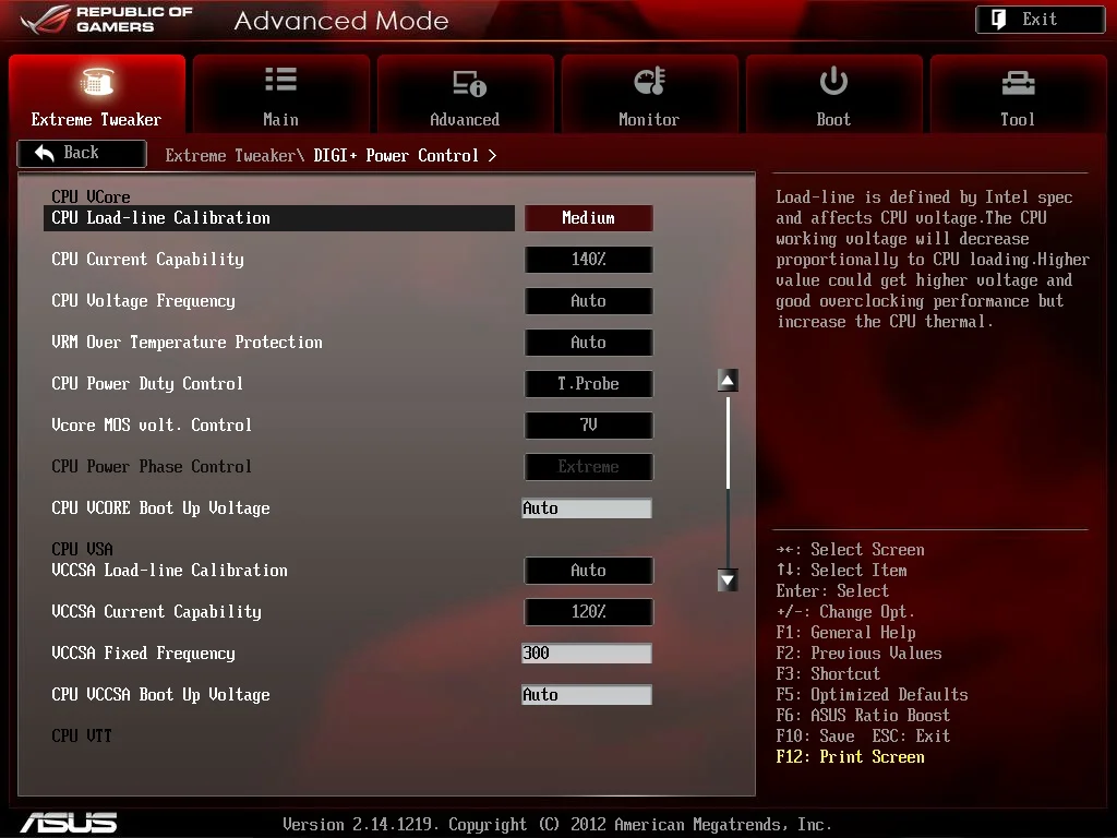

Have you fiddled with the LLC yet?

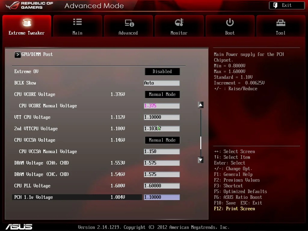

Been using 1.375v from bios with medium LLC on which gives me around 1.384v idle then 1.365ish under load
Also try with low PLL 1.65 or 1.6. Tune the CPU scews too this helps especially when using high BLK.

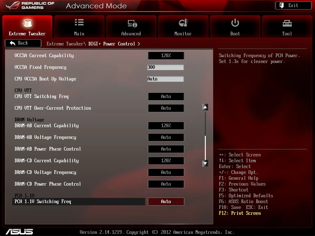

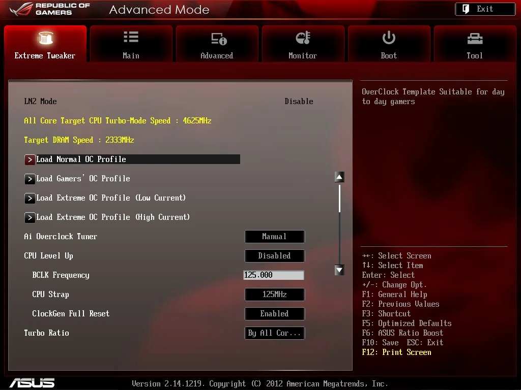

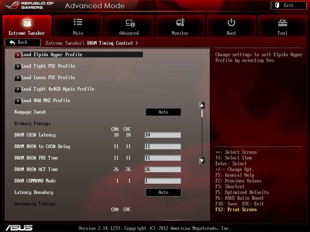

Sorry to be a pain, could you just check of these settings to see if they are ok.
Looks fine to me.
