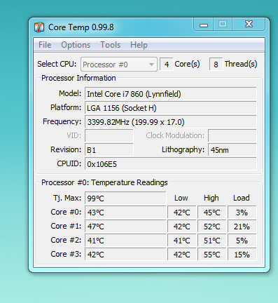

Hey chaps,
Would you say that an i7 860 overclocked to 3.4Ghz with HT on with these idle temps are not really all that good considering i have a Prolimatech Megahalems Rev B with 2x Scythe Kaze Jyuni fans and using Shin Etsu thermal paste.
Im just not impressed with the idle temps. :confused:
i mean look at core 3 high temp idle 55c?

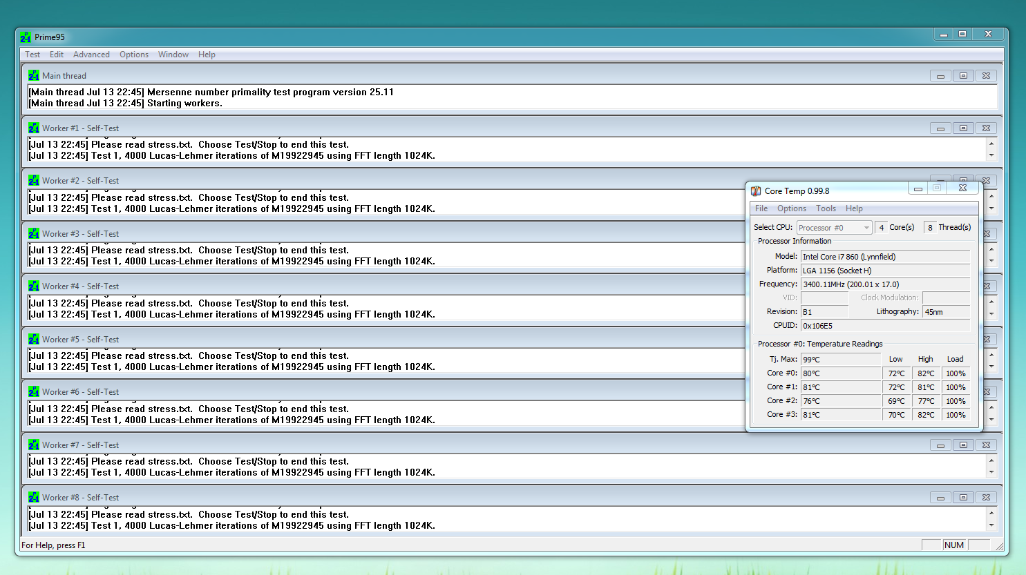

Well these are my temps for about a min into prime 95...its just un-aceptable imo,considering this is suppose to be a good cooler.
I think if i let prime 95 run it would hit the TJMax and shut down the system.
Whats your ambient? Although after 1min i'd say yea thats bad, IBT would likely hit Tjmax quick! . Reapply TIM and reseat your sink.
Not sure on Ambient as i have no thermometer,But its not all that warm in the house and i have my windows open.
But yeah after about a min it shoots to those temps,I dont even get to test 2 as you can see. :/
EDIT: @ScratchFive according to cpuz the voltage is 1.360..its on auto in bios for voltage,maye this is the reason its so warm,But i thought the cpu would only consume the power it needed?
auto in bios sometimes sets the voltage way too high, I think this is part or all of the reason for the excessive heat.
try reading this http://forums.overclockers.co.uk/showthread.php?t=17612922
and set the voltage manually, you will get much, much better temps and probably a better clock too!
edit: the CPU has a resistance that, while not fixed, varies within limits dependent on load, temperature and other factors. Putting more voltage across this means more power is consumed (P=V^2/R)
