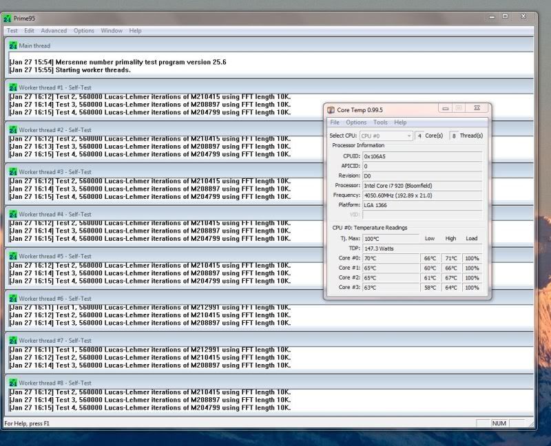

P95 SE 2000's
Not as low as a few weeks ago with the pwm setup (iirc i had the windows open then on a cold night). Still though, a few degrees lower than LinX. If i can source a good fan controler for all 6 installed fans, i may keep theese 2000,s on the cooler.
