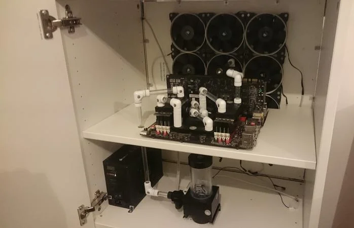

My fabulous ship
so I'm not using my corsair 600t anymore, instead switching for a bigger rad (1 x 9 instead of (1 x 6) + (1 x 3)) as a result I needed a case to hold it.... I also wanted to blend in with my living room furniture so it doesn't stick out like a sore thumb....
I still need to wire up and need some more fittings before it's complete (on back order)
current mess :p :)
next post will have more picks and complete

so got a bit of a problem, I'm now getting post 00 message and CPU light is now red.... no post... uh ooooh......
I've had a google about and there are some possibilities:
1. The board is being shorted out somewhere
As it's an ikea box, I had to cut into the box a lill (make a small groove) for the gpu metal bracket to fit into, could this short out the mobo if it was touching?
2. CPU is dead
I haven't actually removed the CPU since the first time I put it in so this is very unlikely the problem
3. Mobo is dead
The mobo does have a slight bend to it, but I can't tell if this is enough to mess with the system
4. ram is dead
I noticed that not all the ram slots were in properly (out by a mm), I've since put them all in, but still no post.
I'm now going to have to drain the loop and test each part again... I hope the motherboard isn't dead......
yep, I have 1 slot of ram, the gpu and cpu in the mobo, and still getting the same error message.
I have taken out the cpu to check the pins and it is all fine.... i think it's the mobo because until now, the cpu hadn't been removed for 3 years.
where do I test from here? I am pretty sure it's not a short out, the mobo is on a wood base and raised from the screws like a normal pc... and even then, it's wood not metal.
I've done a full cmos clear - removing the battery and power... fired it up with just the cpu in and all same result... really strange
Looking at the pic it looks like the Mobo is secured directly to the wood - I have always had issues if the board is not fixed to a motherboard tray - I suspect it needs to be earthed. When I have previously done similar stuff I found mounting the whole thing on a tray fixed all my issues.
