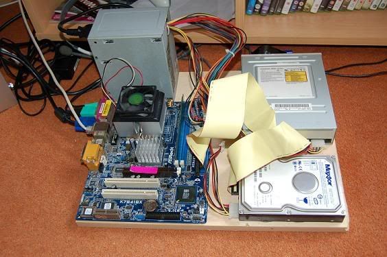

Hey Guys,
I've been in and out of this forum and F&H in general for the past 5 years however due to other commitments i've had to give up my contribution for the sake of other things. However I am pleased to say I am back and have also started a new project, to create a folding farm with a grand total budget of 0 pounds :eek::D here is the first computer i have managed to conscript:
Its a semperon 2200+ and 1GB of RAM, as you can see its all been bolted to a sheet of wood and will be added to the rack that has yet to be built out of an old bed that will sit in my garage. Over the next few weeks I will be adding the following:
AMD 64 3200 w/ 2GB
AMD XP 3200 w/1GB
2 x Dual PIII w/2GB (formally a pair of HP LP2000r's that have been saved from the skip when a local company that went belly up)
Sorry to say there are no quad cores et al but im sure every little will help, being very out of touch with things means i have yet had the chance to look into using GPU's PS3's and diskless farms however I now have the time to do some reading into it.
I'll be adding even more machines as and when i can beg/steal/borrow them however it is of the upmost importance that the entire project costs me absolutely nothing.

if you pay the electric bill, it's not going to be a £0 project with spec's like that.
Sell the lot bar HHD and PSU, get a paper round - buy a budget C2D - whole folding system shouldn't cost more that £70 (chip, board & Ram) from MM
With smp client it will net you the same as 20 or more pc in that spec bracket using less juice that one of them.
Just my 2p worth
Edit: don't let me burst your 'project' bubble as there's a lot to be said for building and testing pc's but old tech farms are not sustainable
Maybe worth offloading the lot and buying a PS3? I could easily get 100 quid a piece for the LP2000r's on the bay
