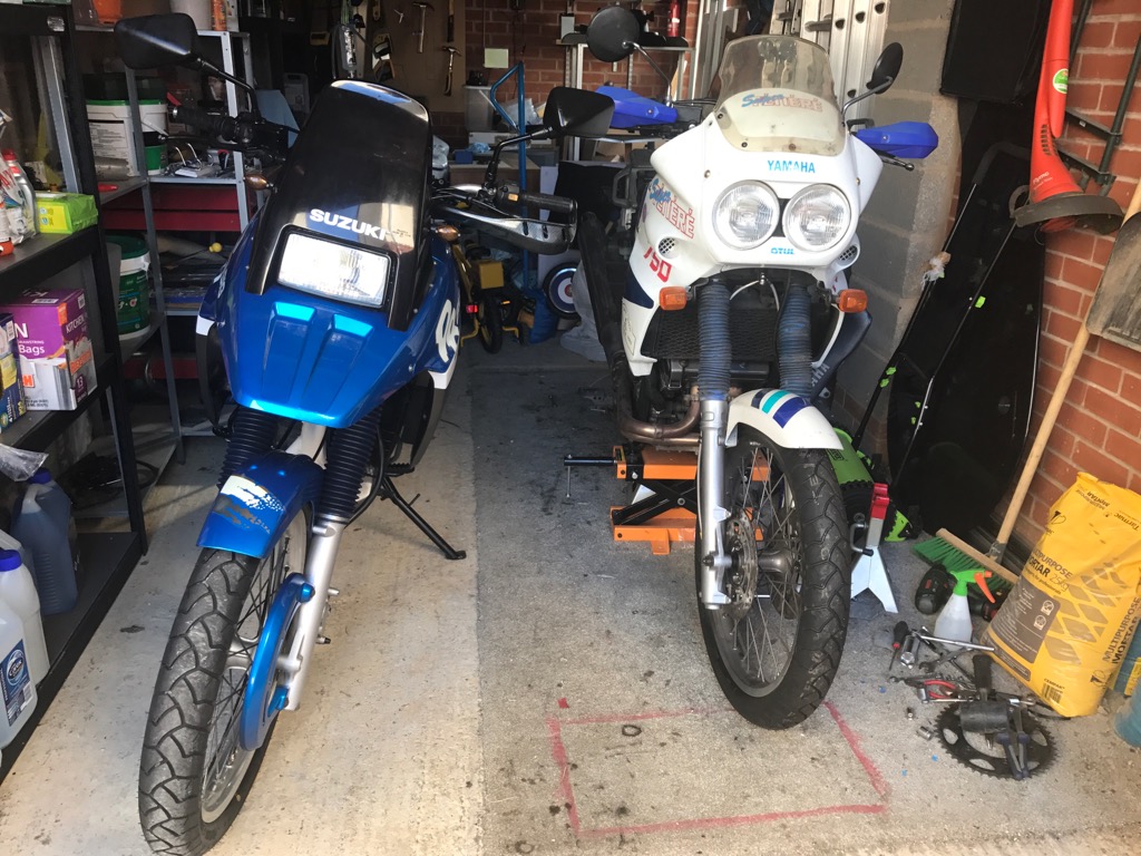

They make a great pair :D
Love it, those DR800s are ridiculous, I rode a mate's one once on a private road many years ago, it's got enough torques to split a car in half :D
