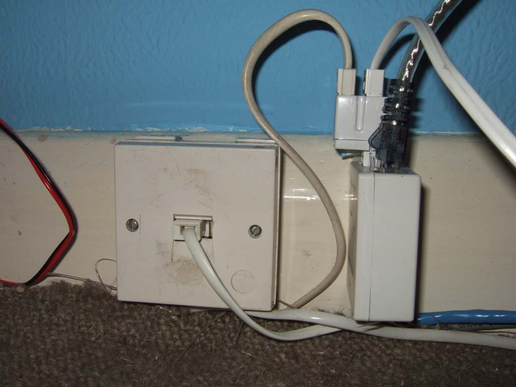

I've just been trying to improve my line stats. Over the weekend with a couple of changes I've got it from 53 att / 17 noise to 52 / 23. With the calculator to try and estimate the possible max speed I've gone from 2.5mb line to 4.8mb line.
This has been done by plugging my router directly into the filter which is in the master socket and not via the 2 extension leads and surge procector I had before. I have also bought a Belkin high speed internet modem cable from the filter to the router which also dropped the noise margin 0.5 of a db which don't sound much but added 200 - 300k to the max line speed.

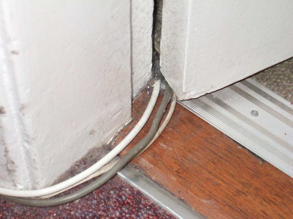

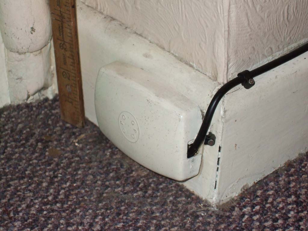

I've got a really old master socket in the house, like over 25 years old. We had a new telegraph pole and new wire from that to the house in the last year. The wire when it enters the house is new but then goes into a oval shaped box which will also be 25+ years old. From that there is another very old length of wire to the socket.
Would there be any gain by having that oval box, old wire and old socket all replaced with new wire, nte5 socket and filtered face plate?

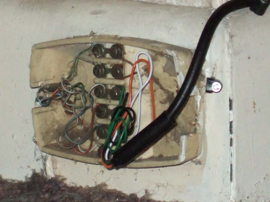

I've just taken some pics of my setup so people can see what they think...
Socket
Grey wire
Oval Box
Inside
Inside the oval box it's using the orange and white wires from the new line coming into the house. Then there is just a mess of wires from the grey cable going to the socket.
Anyone got any thoughts?

Get a BT ( has the little BT sign) master socket with removable face plate suitable for the replacement with a filtered face plate. put this where ever most suitable and then run a 2 cable wire from the incoming cable to either A or B connection of the Master socket ( it don't much matter which) You may be able to directly replace the OVAL connector with a New master socket. Naturally one would then run a direct cable to ones puter/router
more info here:
http://www.clarity.it/telecoms/adsl_bits.htm
