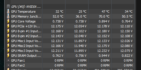

Hey all,
finally managed to get the EKWB 3090FE block installed. Shared on Reddit, including screenshots from Furmark tests. Really not too sure what to make of some of the comments regarding performance, which sees GPU max out at 54 deg C on core and 70 on memory junction under load. This compares with 104 deg C with stock cooler.
I’m fine accepting card may not be best performer, looking for some expert opinion here :)
https://www.reddit.com/r/watercooli...urce=share&utm_medium=ios_app&utm_name=iossmf
Might of missed it but what RPM are your rad fans running at ?
It doesn't look like you undervolted the GPU either which does help a lot.
Currently reassembling my loop with a 10700K, EK 3090FE and 2 PE360s. I'll come back to compare.
well al ot if going to depend on your loop, water temp as would want to compare the delta of that to your GPU temps. That said, your temps seem reasonable of course. Thanks for highlighting your memory temps was what I was most curious to see. That is a nice drop on the memory temps IMO, makes any full active backplate superfluous IMO in most cases.
Ahh just seen your post, your sitting at 32 degrees coolant temp? if so I think that is slightly on the warmer side to be honest. Talking 22 degree delta from fluid temp to GPU temp, warm but would not say overly bad.
Thanks @Radox-0 @momo56 for coming back to me. I was super happy with massive improvement over stock, then so,e Reddit commentary went and put a dent in my enthusiasm lol!
Will check fan and pump rpm tonight and feedback. With no space for additional rads/fans, and not chasing any kind of superhero benchmark performance, wanting to just get on and use the PC, I’ll be happy knowing I’ve optimized my current setup as is.

That's mine after using furmark. +900 on the VRAM at the moment.
Not comfortable with using furmark though it's unrealistic. 400w usage and the core is at 1400mhz.

Thanks a lot for sharing @momo56, those temps look very similar to mine. What do you think about Heaven as a benchmark?

Thanks again for sharing, reassures me that my block/card seem to be performing within norms.
@momo56 do you know what your ambient is and water temp settles at? My ambient is 20, and water at 31, so +11T delta, seems a little toasty?
