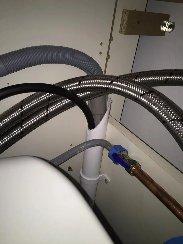

There is a plug which was destined for the dishwasher but it's in use for the water softener. Thinking of getting one of these converters to add an additional socket. I assume this will be fine?

1. There is a long drop pipe which the washing machine and water softener goes into. The problem being that there's no more room. Can I expand it? It seems to be higher than the softener which I heard was bad, but it was professionally installed...

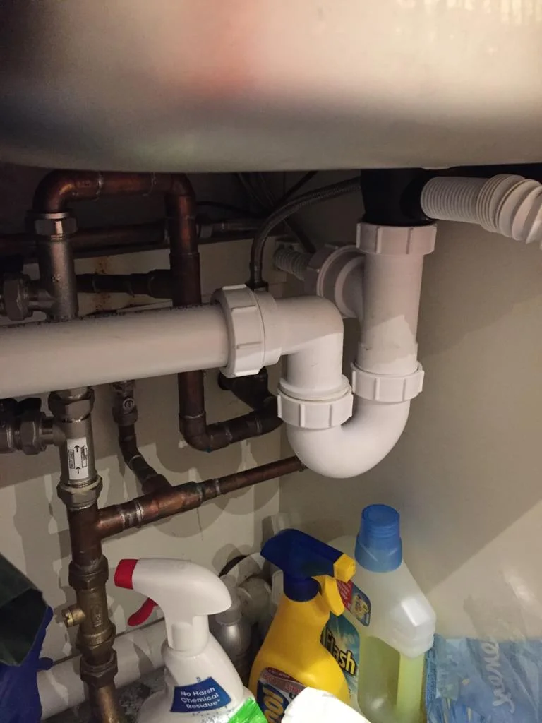

2. There is a cap on the sink u bend which I believe can be cut and attached to. Isn't there a risk of the sink draining into the dishwasher?

No idea on this. There is obviously a cold tap (both softened and hard water) for the sink but it is all copper pipes. Any easy way to attach? You can see the setup in the bottom pic.

The socket looks like it needs the actual cabling changing so as long as your comfortable doing that should be ok.
Yes the white thingy should be cut off so you can force the outlet hose from the dishwasher onto it. I highly doubt sink water pressure would be able to force its way into the dishwasher, they pump quite hard to force the water out.
Looks to me like there is a cold water outlet at the back up against the wall, which the current picture is obscuring the top of, its got a screwdriver valve showing just below the white waste pipe almost mid picture. Or is there something already attached to that?

I think that's the outside tap. There is a pipe that goes to the dishwasher. I was thinking of getting a self cutting tool and just adding to that pipe as the pipes around the sink are small in length and difficult to get near.
Wont be a problem having the dishwasher enter the trap like that, fairly standard. Most dishwashers have a non return valve so if the trap was blocked up and water entered the drain pipe of the dishwasher, shouldn't damage it

1. the plug converters are fine, i used one myself. (had 1 socket for fridge/freezer but i had a fridge and seperate freezer so used one of the socket converters)
2. cut off the white thing under the sink and plumb into that.
3. picture 1 (turn off water, cut off pipe, install this http://www.screwfix.com/p/compression-appliance-tee-brass-x-x-15mm-bsp/24030 done the same recently (installing 2 washing machines next to each other off 1 cold water feed)
since its above the trap wouldn't the smell from the used dishwater cause a problem? would have thought it would have been under the trap im no expert like ha
No, it should be fine - I have it plumbed in like that at our house. Dishwasher water is typically at 90c anyway, so unlikely to get bacterial build-up

Yes put a branch (forgotton the name for it) so it has two inlets (compression fittings are easy enough to fit)

Dishwashers usually just a need a single cold water feed, that blue thing in the other picture is the cold water feed to the washing machine or water softener you can get a simple Y-splitter that screws into the end of the cold water feed so you can connect two hoses to a single feed.
http://www.screwfix.com/p/washing-machine-y-piece-bsp/81000
Ah okay, so you would branch that off rather than use the sink u bend?
Not sure that would fit. I was thinking of getting a compression tee with two valves and just replacing the single valve on there.
