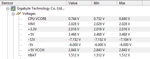

Could someone explain exactly what these voltages are for?
Do I need to lock them or anything while adjusting the CPU voltage, or can I leave them on Auto (what I assume they are on now). The only one that fluctuates a little bit is the -12v reading, but it always remains at roughly 7.1v~.
some are the output of the psu,some are for memory I think
