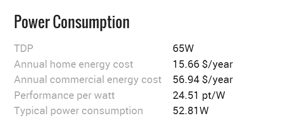

Having looked at the different chips, the i7 4790S (65W) seems the best one for a low power small form factor build, the max turbo is 4GHz, the chip is optimized and binned for lower power consumption. Because it can clock high it completes tasks quickly and uses less power while doing it.
Compare the 4790S to something like a FX 8320E, and not only is the working power consumption lower but completes task in half the time, meaning AMD have nothing to offer as an alternative.
i7 4790S the chip I will put into this build.
