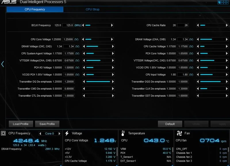

Hmm, seems the 4.5ghz while it passed real bench, did seem to have a hang on windows boot - may not be related but knocked it back down to 4.25ghz.
Any suggestions on what kind of increments are best advised as this level OC to reach 4.5/4.6?
Hang on Windows boot add cache and maybe a touch core. just 1.275 both try. 4.5.

Oddly it worked for a few resets on 1.25 @4.5 & two 15min tests you mentioned. It crashed on windows load (but posted fine on boot).
Volts on the cache or up the frequency of the cache (to say 3750mhz-3500mhz). or 1.275v to cache & core?. Apologies if stupid question, as cache volts much lower atm (Cache Volts 1.15)!

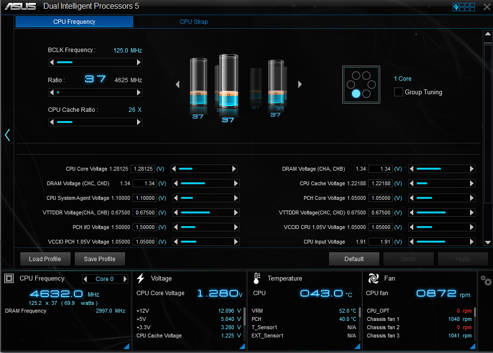

Managed to get it to this so far, will have to check stability as doing some GPU OC'ing also - done a few tests & benchmarks on just the CPU & it's fine - temps so far are in the low 70's during high stress - gaming in the 50's.
Had a few blue dot crashes + lockups on a couple of games - I'm guessing there is very little chance of this being CPU related. Have done a full driver sweep & pulled down GPU clocks a touch & not seen once since, I guess testing is the only way to be certain (GPU benchmarks are a waste of time for stability, witcher 3 4k is the real test lol)
Hmm, would you say from the temps/volts I've got much room to potentially push this much further?. Thanks for the advice btw, it's amazing to have one of the top over-clockers around to get tips from, excellent bonus of being part of this community.

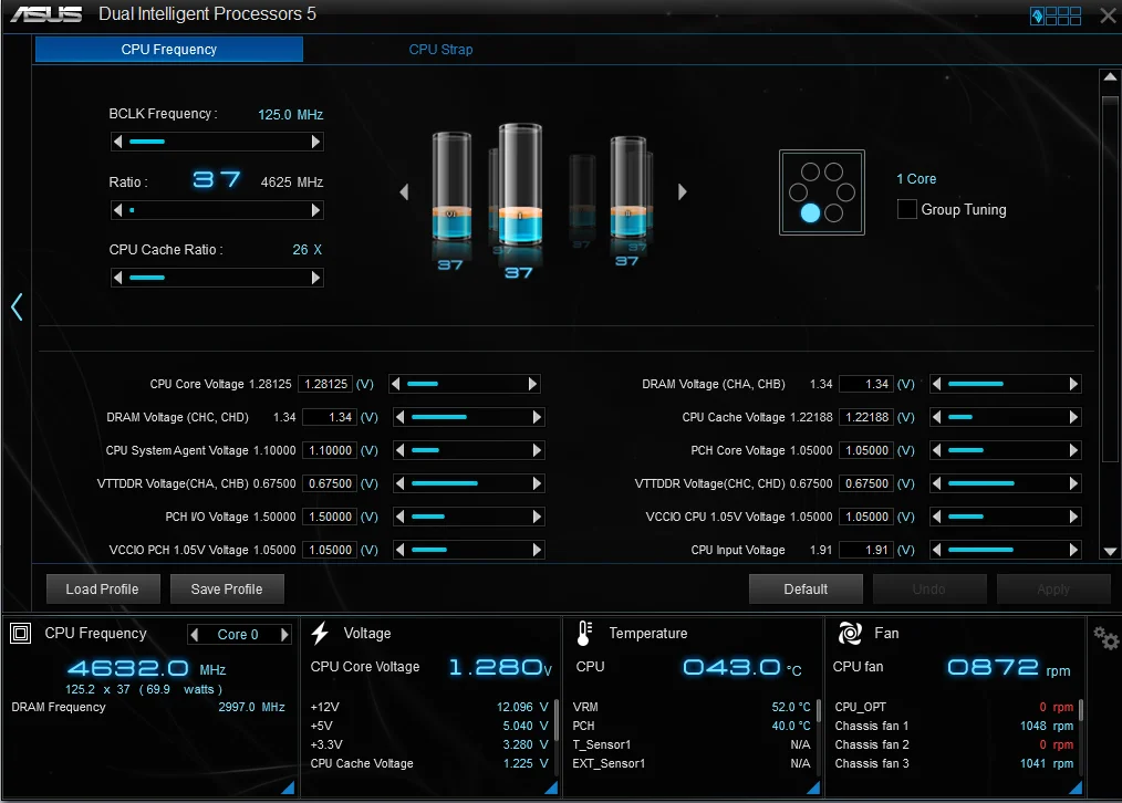

Hi 8 Pack,
Any tips on how to push the chip to 4.75, I've now got it in a custom loop so my temps are much lower.
What are the safe 24/7 volts for each component I shouldn't push past which I'd need to adjust from the above.
Atm my settings are at
Clock
4.5ghz Core.
26 Cache ratio.
125 BLCK Ratio
Power
1.28 Core @
LLC Level 6
+140% CPU power
1.2 Cache voltage
1.1 SA Voltage
1.9 Input voltage

Okey doke, so pop the cache multiplier to 32 & try upping the core clock by another one increment.
As my core is at 1.28 at the moment I'll pop it up to 1.29/1.3 & see if I can get to a comfortable 4.625.
What kind of performance benefit does Cache multi clocking provide?, thanks.
