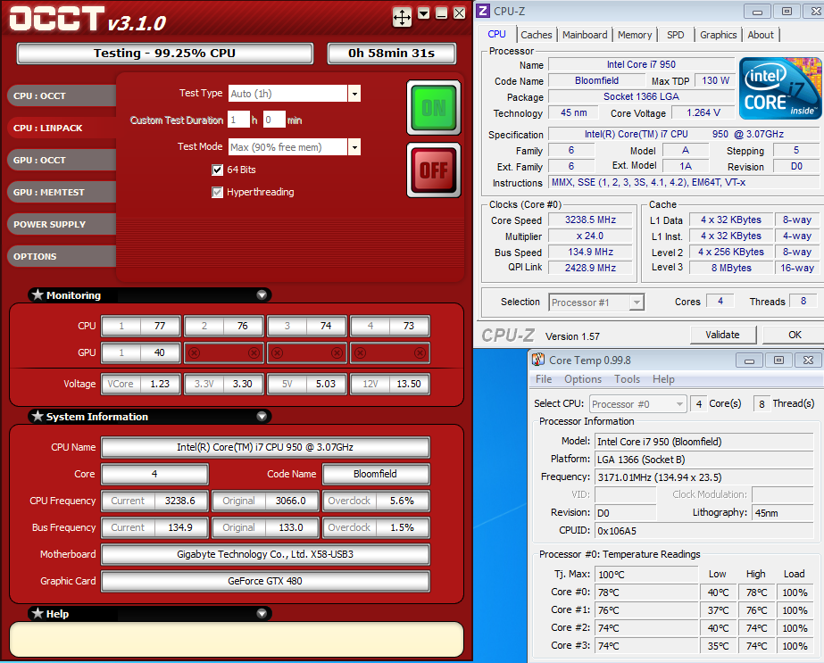

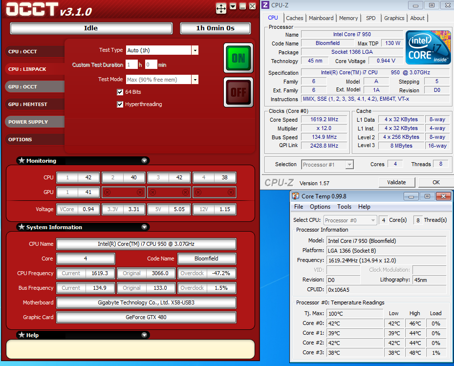

hi, whats the max temp for these? i have found the voltage range and every other piece of info, just not their max temp. thanks in advance.
idle
under load
Tcase is not the same as core temperature. They will not throttle until core temperature (measured with Real Temp or Core Temp) reaches 100 °C. Personally I'd say as long as you stay under 90 °C when under full load (Prime95 or IBT, whichever makes your CPU hotter), you're fine.
Those temperatures at 3.2 GHz are high though. If you're not planning to overclock then you're fine but if you are, get a better cooler. If you already have a good cooler then I'd suggest remounting it.

oh, well this is good, i was panicing as it kept going over the 67 °C. so its safe up to low 90s under complete stress load?

bare in mind you've got HT on, on a stock cooler, whilst running a prog "deisgned" to intentionally kick the bejeezus out of a cpu to push it till it falls over, so unsurprisingly it's running hot. :)
don't underestimate i7 chips ( 920/30/40 etc ) there tough chips, a damn sight tougher than the new i5's, if your genuinely worried, change coolers, which i personally would & do do as a matter of routine, as ive never been impressed by the performance of any stock heatsink.
