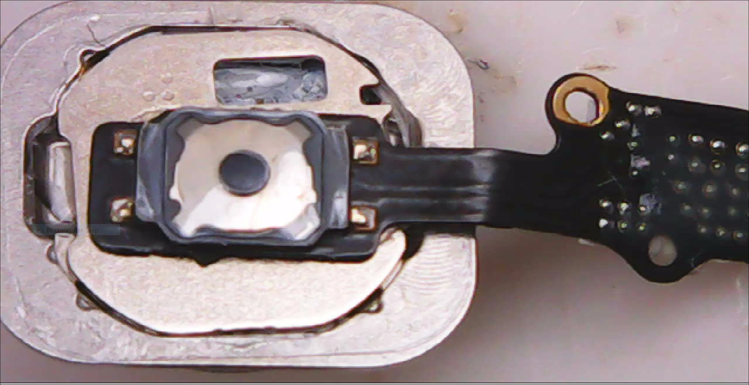

I tried a new button but it was of pretty bad quality.... reseated twice using new gaskets, but still no go. Seemed very stiff so I gave up and put the old button back in. Shame tbh because all parts we ordered so far were spot on.

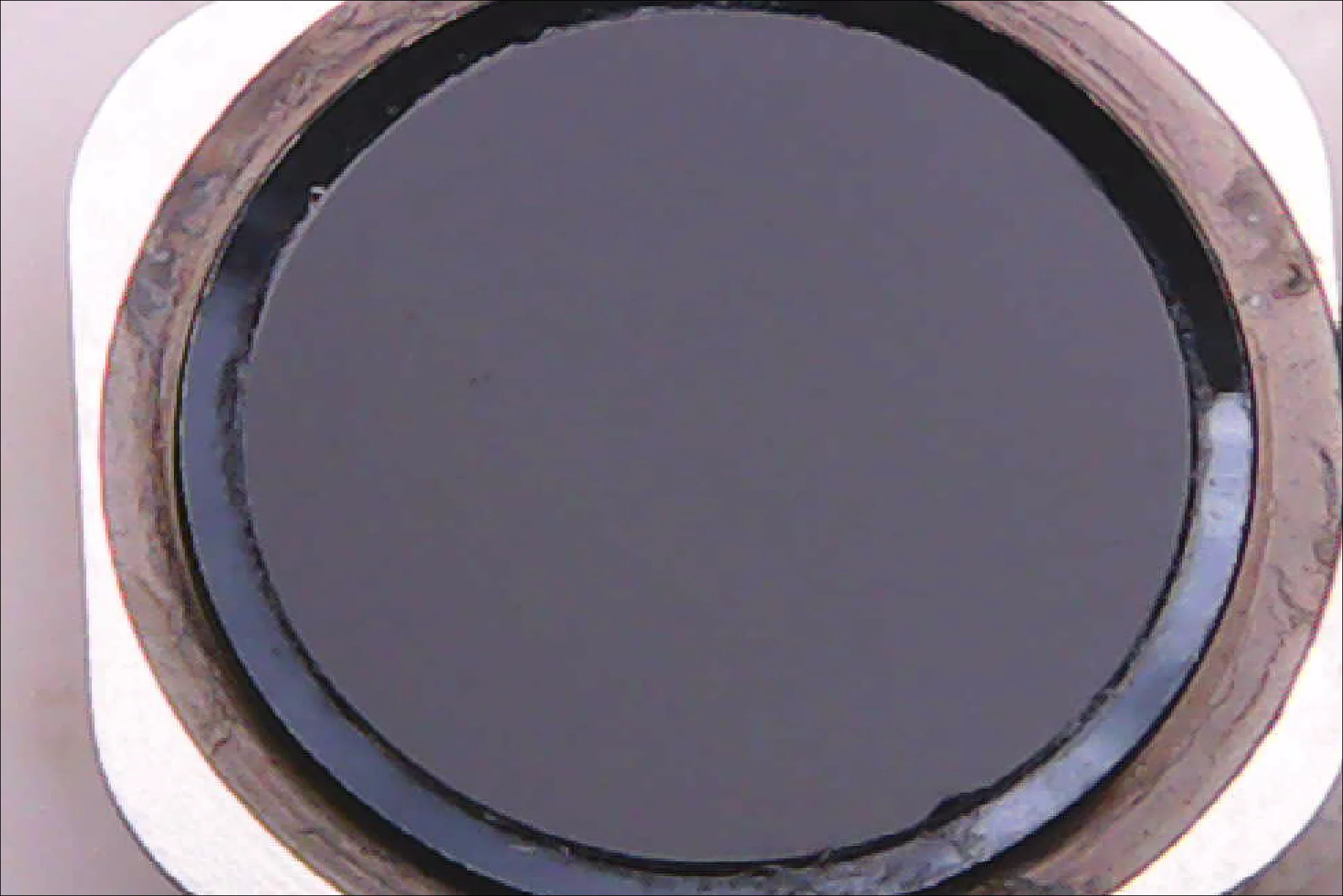

That is a VERY bad home button! That's been opened and chewed by the looks of things.

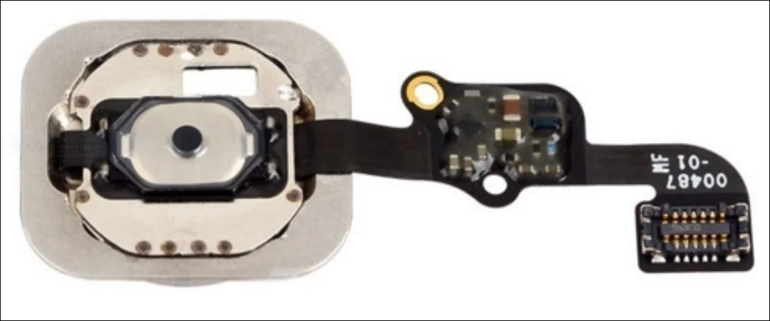

Yeah I need to talk to the supplier and ask what has gone wrong, It was sealed in one of those anti-static packs but looking close it seems that they do break stuff down and recycle old parts on the site. But that button isn't even OEM, If you look at the cable it's a button only setup. IE a proper OEM button will have the cable tucking underneath the button housing like this.... at a guess to feed the fingerprint sensor ??
Infact if you hold it up to the light you can see daylight (perfect for water ingress) through the side of the inner black disk, I didn't even give it a second look till after I pulled it back out of the phone, then you can imagine my thoughts when I looked through the scope thinking isn't this brand new!
The only assumption I have is this is a very bad mod of an old button.
